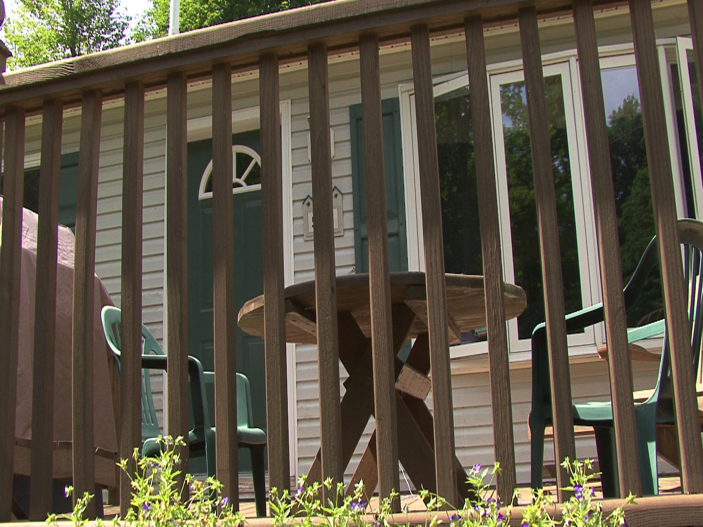

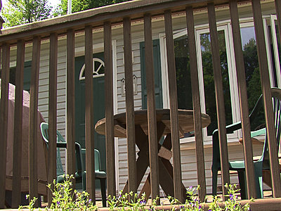

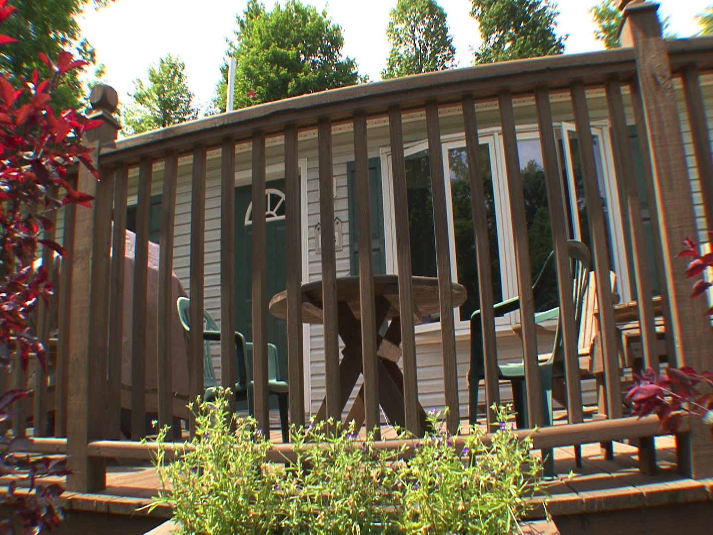

Here are the stills I promised...a few days late! These are straight 1440x1080 frame grabs. One with the attachment at full wide, one without the attachment at full wide. As you can see, the distortion at full wide with the attachment is pretty severe. Too severe for me.

I don't mind the distortion from the bowing of the straight lines. I mind the severe Chromatic Abberation and fuzziness at the sides and corners. I guess that is why Sony only elected to use a .8 WA on it.
