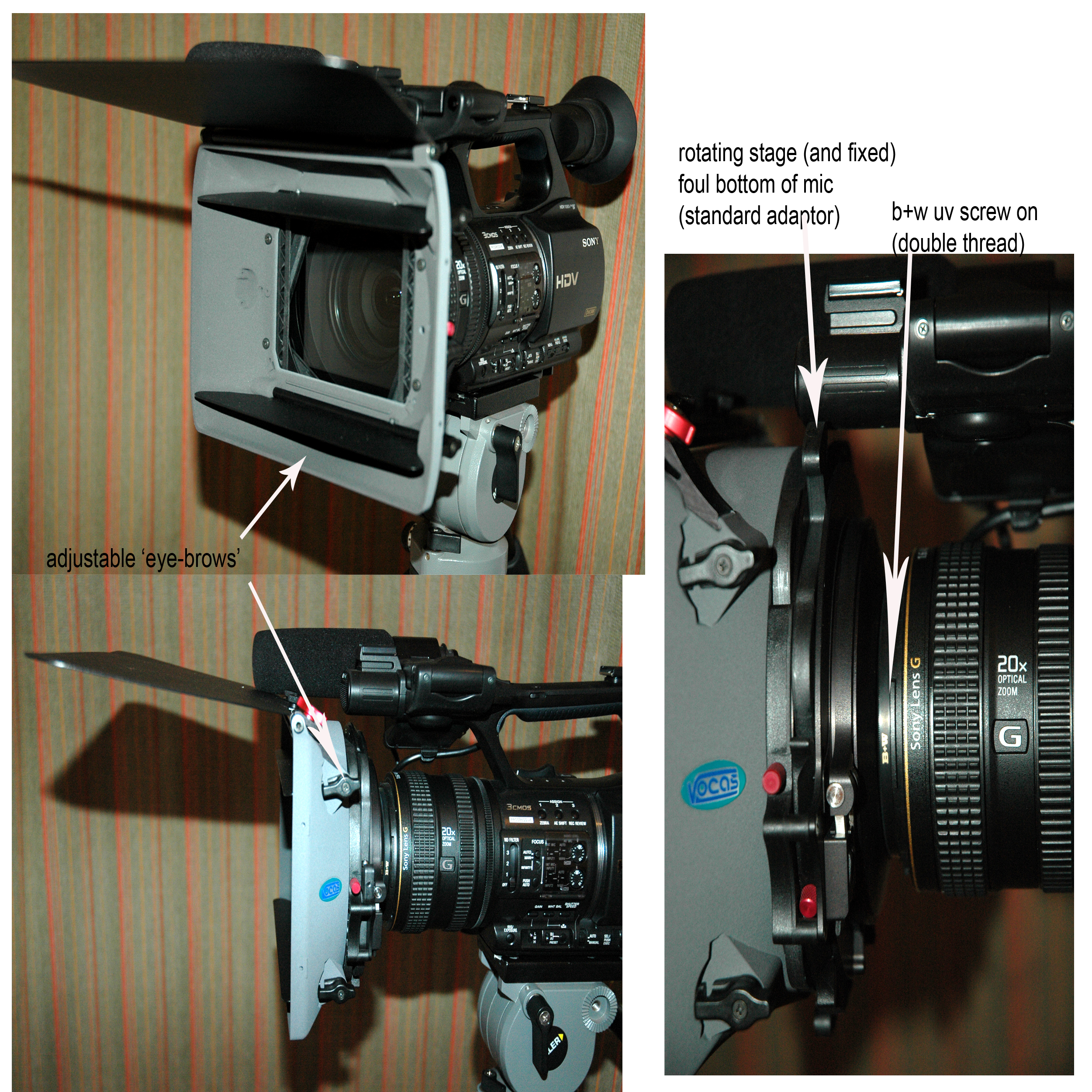

ok, out for a week with my new matte box:
DV MATTE BOX 4X4 MKII WIDE - Schneider Optics
pros.
exceptionally, and i mean exceptionally, well constructed.
great eye-brows, almost no need for included sunshade.
extremely light.
screw on very, very secure, and the clamp is limpet like
cons:
well, it's bigger than i really wanted - so it has to come off for transit. not a big deal though thanks to great engineering (the clamp is tremendous) so it's very, very quick to mount.
with the standard adaptor (72mm>105mm) both filter holder 'knobs' foul the built-in mic. however, the front (non-rotating) can be inserted from the bottom, and the rotating stage from the side - which gives me more than adequate rotation for my cpl (and is much more practical to use in the field).
have just ordered the alternative adaptor - which looks to extend the box far enough forward to give 'knobs' clearance.
i'm very pleased indeed, though to be honest, i think i would have been better off with the compact version as i bought this with the intention of getting a wa lens later in the day, but having worked with the z5 in a number of shooting situations makes me think i'll probably get away without having to get one.
if you have the mb200 and are looking at a mb250 for use with a wa, we should talk ;-)
leslie

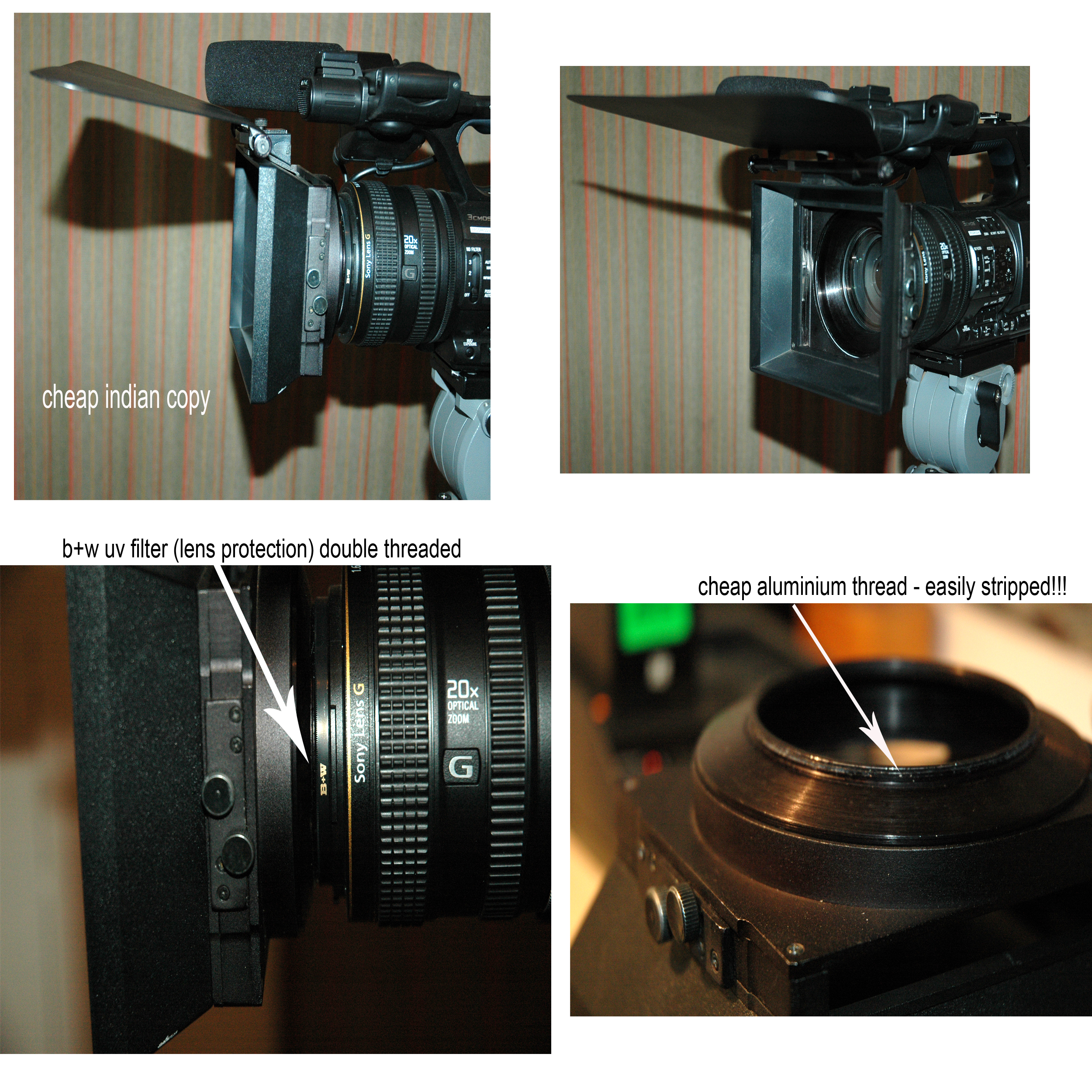

ok, don't know where the other adaptor has got to (probably still in transit), but meanwhile here's a couple of compiles:
as you can see, the indian is a rip-off of the kompendum / century optics. however, for the price it can't be beat - though i would warn about the screw on adaptor - cheap ally, and i reckon it wouldn't take much to strip the thread. the sun-shade lock mech. also leaves a bit to be desired (unless you want to bring the curtain down slowly in the middle of a shot ;-0) in terms of reliability - but it's a relatively deep box, so the sunshade is, in general, superfluous. of course, NO rotating stage, and you have to remove the box to change filters as they'll catch on the shot-gun mic (they clear the built-in.
the other is the vocas - with standard adaptor. pics speak for themselves. great piece of engineering. sunshade sits directly under shotgun - but i have a rode sm3 adaptor for my sennie shotgun that lifts it well clear. you can see the built in mic fouling problem - though as i pointed out, easily overcome, and i can rotate my cpl from the side easily enough.
will post final with new adaptor IF it changes the game significantly. if not, bugger, that's another $150 (au) down the drain....
btw - i use a B+W uv filter screwed permanently to the lens. this is mainly for protection (horses sneeze - UGH!, and flying dirty from galloping ones can make you very protective ;-)). it's b&w's most expensive one with a brass double thread, so no fear there of stripping.
