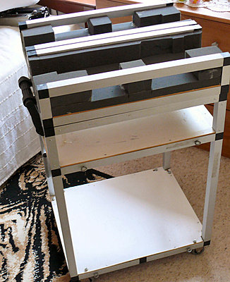

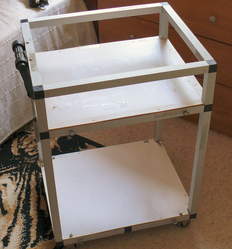

I made my own cart!! Over here we have a rather ingenious little product called "connect-it" They are simply a series of PVC fittings made in various configurations with 1" square tube protrusions and you use them to make your own aluminium furniture by pushing on pieces of anodised (black or silver) lightweight 1" aluminium sections of tube to make, say a coffee table.
I made up a two level trolley using the tube so I have an enclosed shelf on the top where my two cameras sit and then the bigger piece under, fits my lighting case and then mic, battery and other cases and I have two garage storage hooks on the side which fits my tripods and lighting stands.
Metal Mate Connect-It
It makes a smart looking trolley (just add wheels too) and you can customise the size and shape so you can be assured you gear will fit and more importantly the darn thing will fit in your car!!! I just pop riveted MDF particle board onto the aluminium to make the bases. This saves me making multiple trips to and from the car at the reception venue and also you are not trying to carry heavy a very bulky bags around.
Again like big bags ...stairs are an issue so sometimes I have to struggle but normally it's a breeze!!!

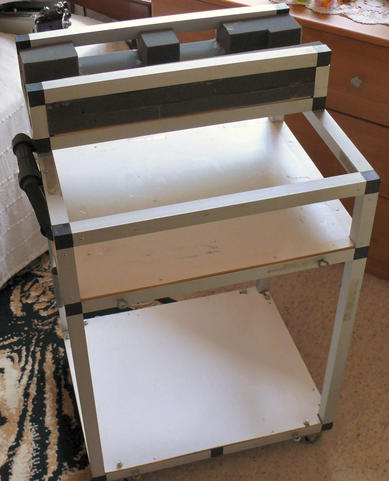

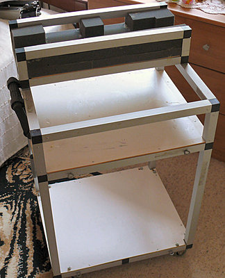

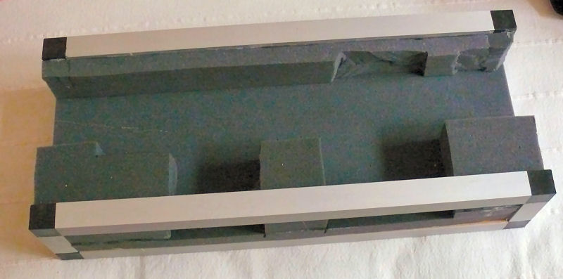

With my cart everything is on it so you have little chance of leaving a case behind...I'm actually busy modifying it at the moment and when the new camera trays are finished I'll post a pic...With the existing cart my lower comparment housing my lighting case and battery and mic cases and tripods/stands and the upper compartment used to take the two Pansonic cameras...I'm now making two extra trays that sit on top of the compartment and are fixed with pins and those take the EA-50's the then blank compartment underneath will be useful for other odds and ends like headphones, clipboard and such like.
The beauty of the trays is that they are foam lined to protect the cameras and pull out the pin and the tray comes off and is now used to house the camera in the trunk of my car while I'm driving so they are dual purpose trays. They sit side by side on top of the cart!! Everything in one wheeled cart!!

Hi Guys
As promised here are some pics of my existing aluminium trolley and then the new camera trays that fit on top if I have to go a fair distance from the car to the reception. The trays have 4 locating pins so they snap onto the top of the existing trolley and cannot slide around. For safety a bungee cord goes over the top as well. The trays normally live in my car trunk so the cams are protected while I'm driving and only taken out when I need to do a "one trip takes all" jaunt from the car to the venue.

Chris, you must have been a designer and machinist in your previous life. Very nice design and workmanship!

Hi Don
It only looks good due to the clever design of the corner fittings!! You bang them into 1" square aluminium tubing and voila you have a professional product ...tools needed are a hammer and hacksaw (I did need a drill with so I could fit the MDF flooring to the aluminium with pop rivets and the wheels with bolts
I made the base trolley so it would fit in my car .... (without the trays, which live in the trunk) and it really does work well and is an ideal type of construction for someone like me who needs 4 guide lines to cut a piece of square tubing otherwise the cut is far from straight. It is amazingly light too!!
