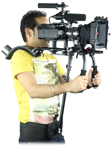

Right here is the perfect situation for Tom ..using both a rod and handles..you couldn't have any better support handheld than this surely?
Chris

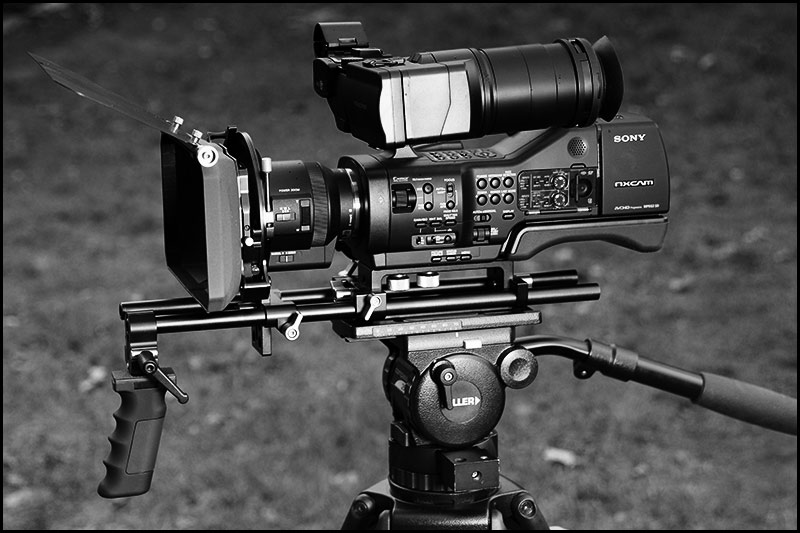

Chris
I believe this will be a perfect solution but is too much for me. I will try now only with handles.
You have lot of handles. In picture they use a "pistol" handle. (only 1 in the picture but I want 2)
Does it matter if choose a pistol handle or a normal handle?
Tom Van den Berghe is offline   Reply With Quote

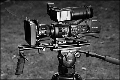

here is the picture
Old March 24th, 2014, 02:17 PM   #26
Location: Belgium
Posts: 9,512
Re: Ok I give up with weights!!
That doesn't look very practical to me, are you going to use it in this set up or are you going to add that suspension rod Chris has mentioned as well? I don't see what benefit this handle has as you can't reach your lens or any controls on the left side of the camera anymore. You could let the handle go to reach for the controls but you"ll likely get a unstable image while doing that.

Not going to add that suspension Chris mentioned.
If let go the handle for reaching the controls maybe I get unstable image. Maybe or maybe not.
Still have the counter weight in this case.
But filmed outside in full auto (just missed the nd filter that time) So no need for controls.
Filming with the prime It is mostly the focus ring I need to control.
