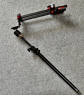

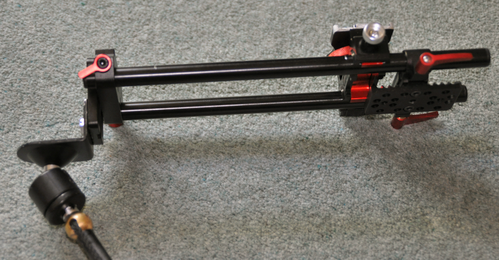

The centre of balance only moved back a small amount so for me it's not the answer. I have reverted to my new ENG rig version now that only adds a mere 300g to the camera weight and takes ALL the front weight off the camera via the spring rod going down to the waist belt previously mentioned.
Having an extra stability point at the front also gives you an amazingly steady shot too.
I think I will abandon the weights at the back as this is really a much better option and much easily from a weight point of view.

The spring arm actually works very well and you can get the Indian version for as little for $70 and the rails are another $110 ... still a cheap option which really works too!! Like my rail system the support is also made by Camtree ... mine is a slightly earlier version and I just bought the rod and belt and added my own mini ball head under the camera.

Camtree actually copied the DV Tec unit I think and their latest version is almost identical at a fraction of the price!! I just got the rod and belt and the rest is bits and pieces. I used to have this on a little fixed aluminium frame under the camera but you do need to adjust the attachment point so the angle is correct for maximum effect, hence the adjustable rails now. DV Tec use a flexible pin under the camera but I found the ball head works really well!! My rod when new was a little sticky so some 1200 grit paper cleaned that up and after washing all the sticky grease inside the spring and tubes it's silky smooth now!!
It's hard to believe but you can actually make the camera front end a negative weight so if you relax your grip on the camera it moves upwards...I find it easier to have to gently pull the camera down to horizontal rather than have to lift it up. Yes you can have the front end close to feather-weight and that's a huge plus when filming a handheld sequence. My last wedding had the bride's grandfather come up and do a quick toast to the couple so I was handheld and he talked for 8 minutes!!!

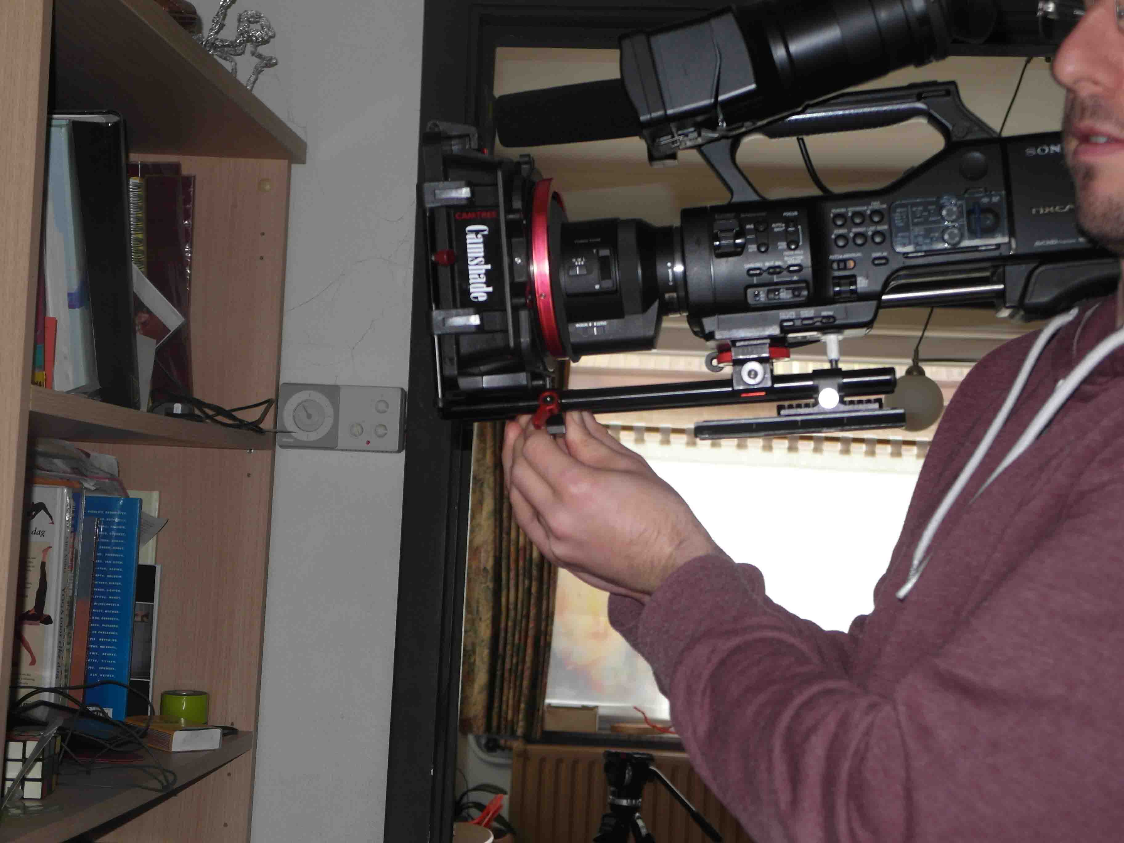

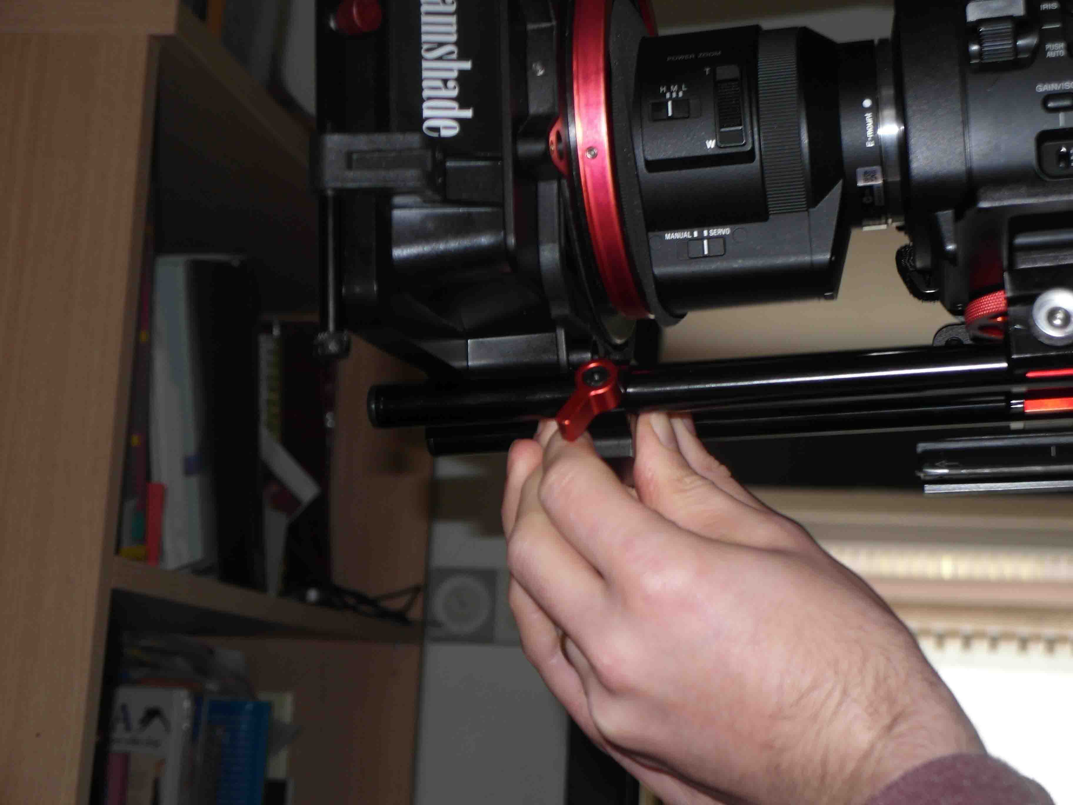

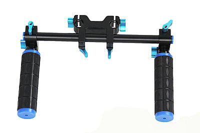

Look at my pictures. I think a "dslr" hand grip will my solution.
When holding my hands there I takes the weight of my shoulder.
In that position I can hold it much longer I think.
I've seen that solution on many camcorders.

My very first rig also had "handles" and yes they will help take the load off but you end up only using one hand as you often need a hand for the camera. I found that I still got sore arms as you are still using your arms to hold up the heavy end and often just one hand so it gets tiring but you will get quite steady shots with grip points on the two handles.
Obviously if you use the handles you can drop the end weight too because some of the 2kg at the back is still transferred to the front. Seriously I think you would be really happy with the Camtree rod support and you can get one for less than you paid for your rail (I think they are listed for $70) and also come with a fitting that slides directly onto your rails.

My rod/waist belt is simply a nylon belt with a "pocket" in the front and the sprung rod goes up to a ball head and the other end is locked onto the rail system. Now, the new Camtree one just has a spring loaded pin at the top at the rail but there is a ball and socket down at your waist on the belt...I wonder if that might be better ..ie: allow the base of the rod near your waist to swivel and then just a minor amount of movement near the camera...with mine the top allows all the movement and the bottom is fixed....Hmmm maybe I should put a ball head at the other end too???
Seriously Tom, I would rather look at the sprung rod and belt ....if leaves you hands free which the handles don't and you are lifting zero camera weight....After shooting for 10 minutes when I "unhitch" the rod I'm quite amazed how heavy the camera suddenly is ....I reckon it's a steal for the price!!
