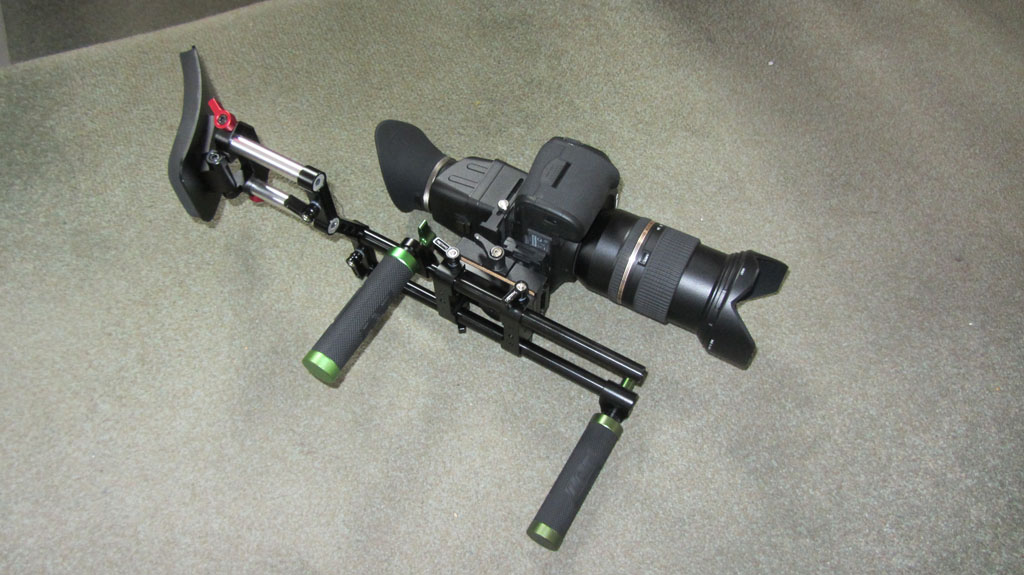

Yes I have my EA50 Chris but I would need this for my 5D rig (pictured) for use at evening receptions - even with a fast lens I find the EA50 cannot cope without the aid of a light - the 5D pretty much sees in the dark :)

That's a front heavy rig so it will be a huge help. My Panasonic rig when I had AC-130's was close to what you have there and your arms also get sore because you are carrying the camera weight and it's being transferred to your back. With a rod support you could keep the handles or not even use them and your hands are now free to do important stuff and not just load carriers!!
I'm doing a wedding in a couple of hours and even use the waist belt for prep video!! It just gives you a much more stable picture!

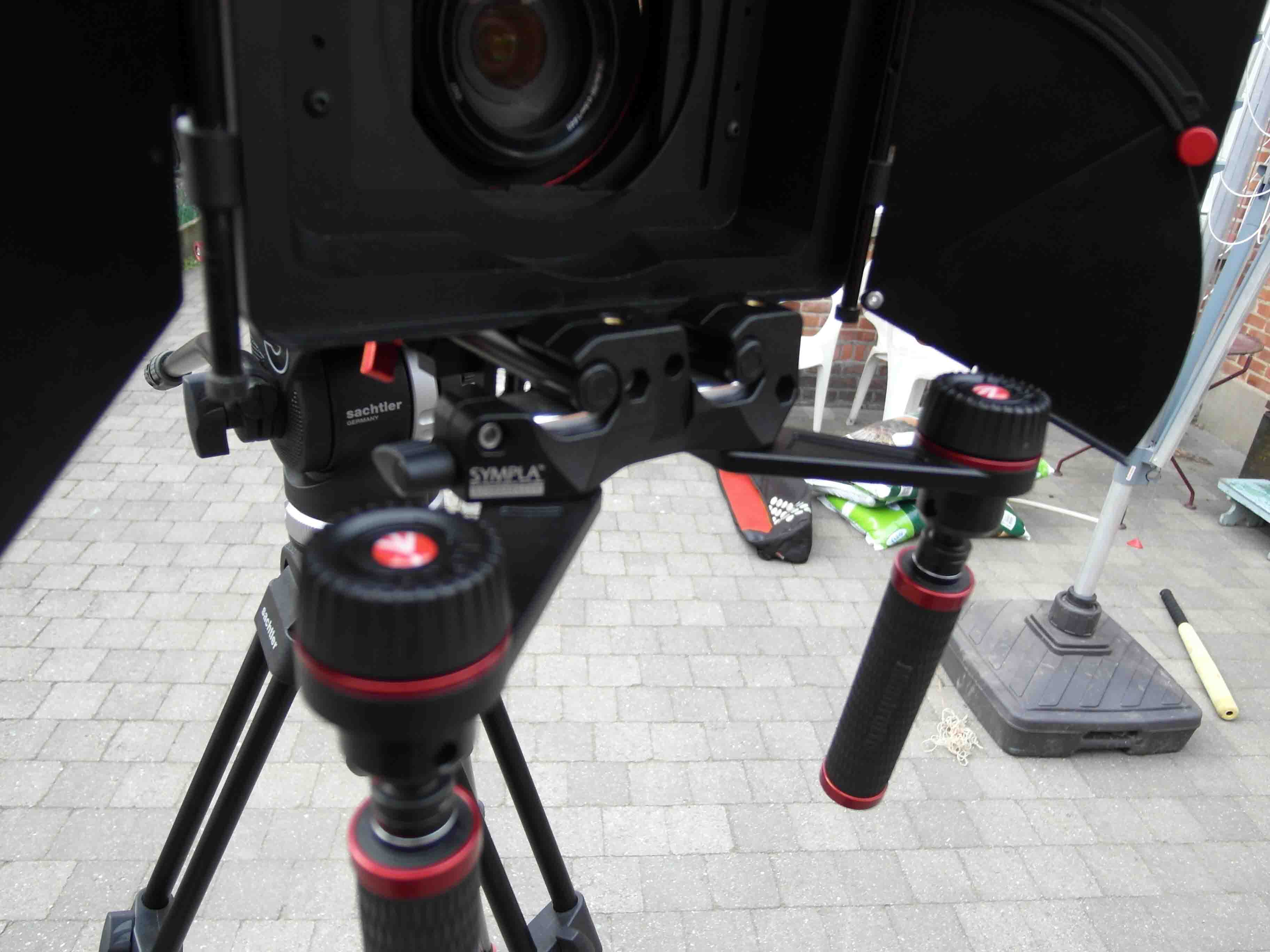

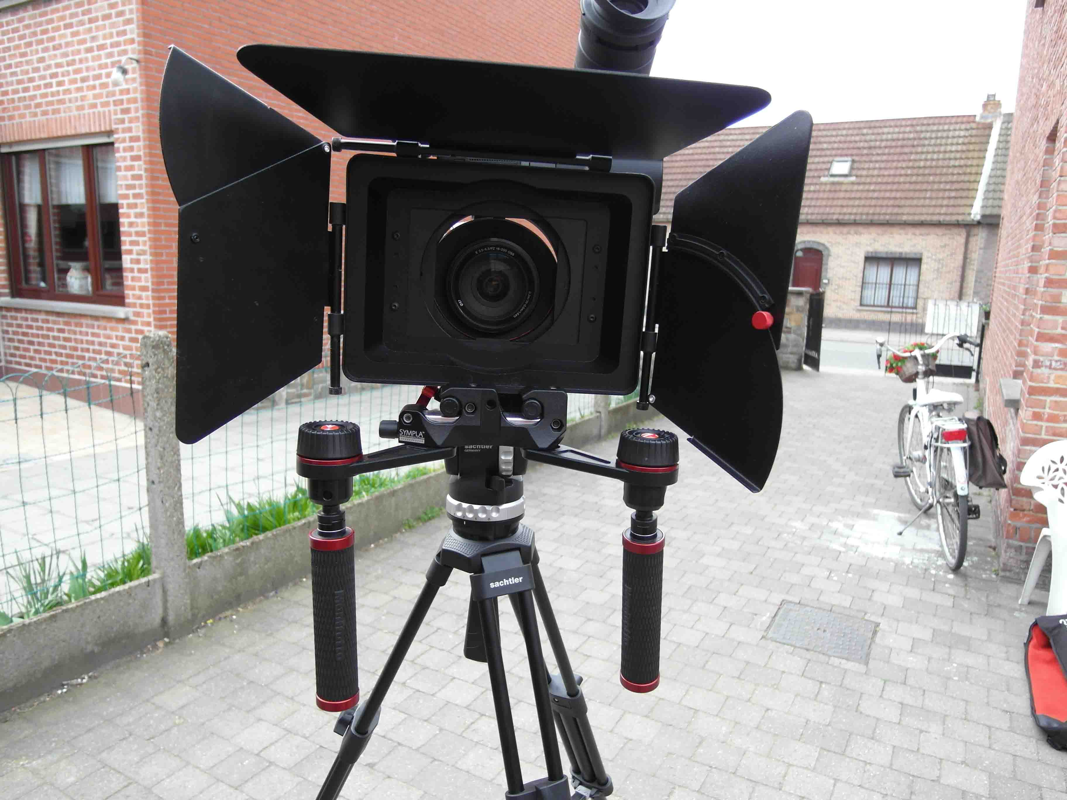

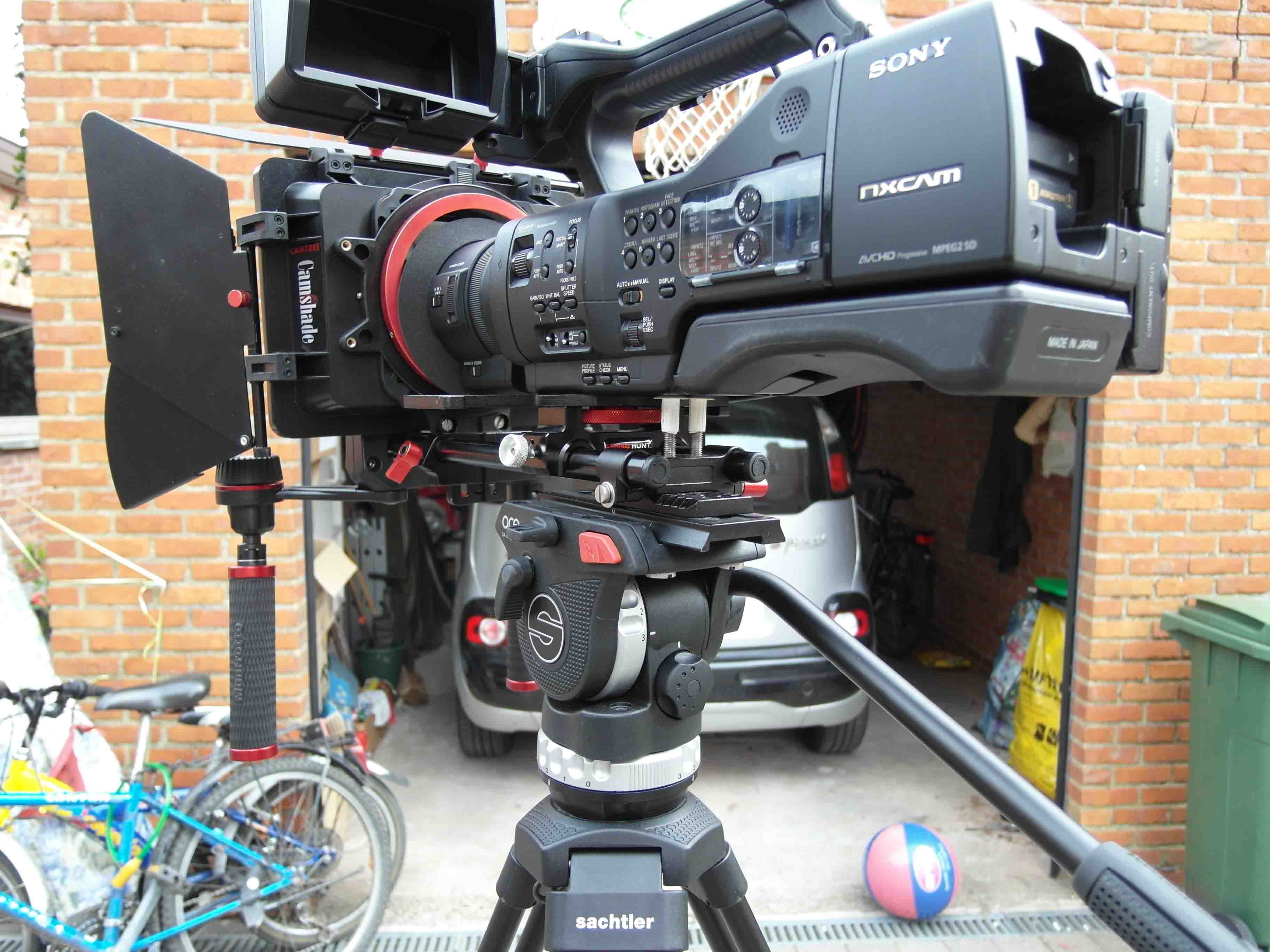

I have my manfrotto handles/ These are the best handles for price/quality I suppose. It takes about 3 seconds to attach or detach them from the camtree 15mm rods.
I have to test further which is the best position on the rods. (can place it also behind the mattebox)
I will make a movie of it later. At this moment I don't use a counter weight.

That looks quite neat!! Let us know how practical it is to use. I often have manual lenses on the camera so I need my right hand under the strap and my left hand to adjust focus etc etc so the handles wouldn't ne practical for me. If you are shooting in full auto, then of course, you can hit record and grab both handles and go ... you have to drop one hand to zoom and start/stop
To be honest I found my arms got quite sore holding up the camera but you are younger and fitter. With my support rod both my hands are free and there is no strain at all on my arms as your hips take all the load. For me it works but may not work for you?
You will find that you can get nice steady footage with the handles too!! I was reviewing footage I did last night at a wedding where I was 90% handheld and it's hard to see any loss of stability ...looks like it's on a tripod.
Chris

Thx for sharing Tom, although you should get more stable images shooting with these handles but when seeing it in action that looks like a very uncomfortable position to handhold the camera for extended periods, I really think you need that suspension rod Chris has been mentioning to get all the weight from your hands, in this way I don't think you'll manage to hold it like that for more then a few minutes. Just after you say, "arestapternekeermeerond" (start moving around) you can see your wife puff under the weight she has to push upwards, that seems like a tough workout :)
