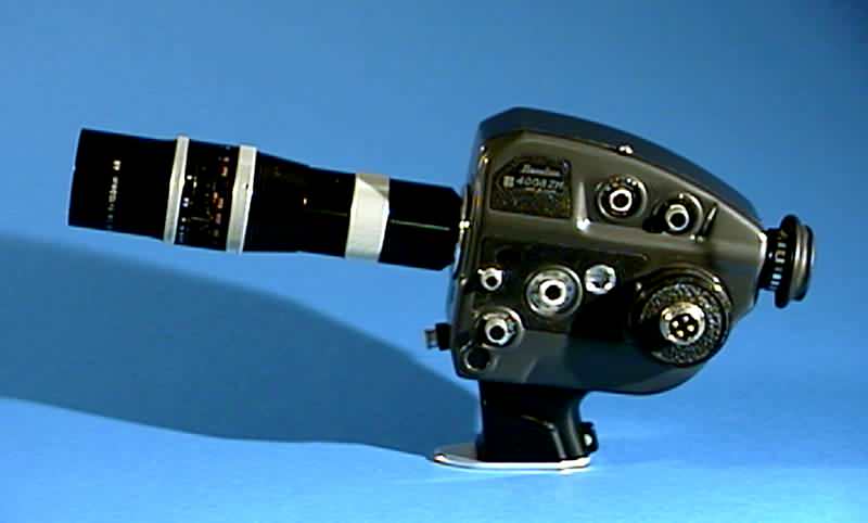

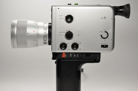

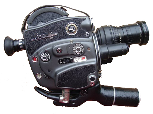

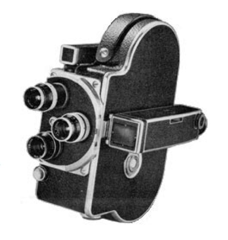

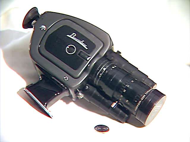

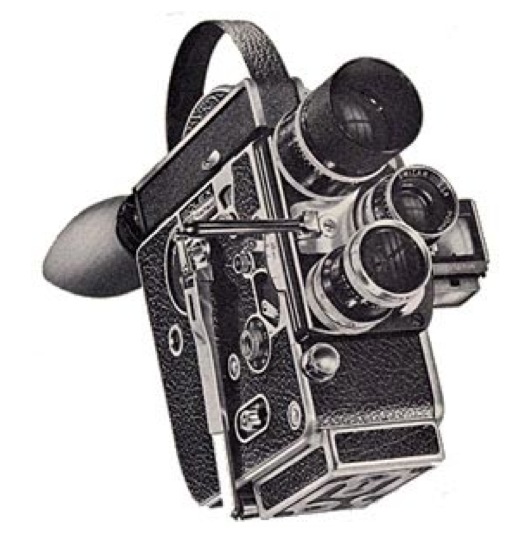

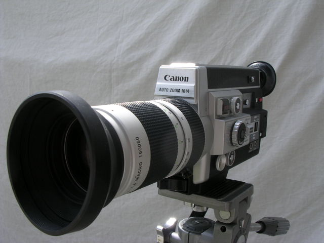

"... it could be that the VG10 appeals to the "old timers" who remember when nothing about shooting was automated. When we see the hand-driven zooms in documentaries like "Woodstock" we get a rush."
Very good. :)
My tag line is "Putting the Photographer Back in Shooting Video."
The VG10 has nothing unnecessary. Nothing but the manual controls needed to shoot video, but with the capability to set each function to Auto as needed.
The big difference between the VG10 and the film cameras pictured is they had a manual control for each and Sony has gone with an computer interface -- one that would never have been accepted by Steve Jobs.
I shot in bright daylight and with the shutter-speed at 1/40th second the aperture was between f/16 and f/22. Clearly an ND filter is needed.
PS: I've owned the 4008ZM and the K2.
Sony NEX-VG10 AVCHD E-Mount Lens Camcorder-beaulieur16.jpg   Sony NEX-VG10 AVCHD E-Mount Lens Camcorder-rightsideallprogress.jpg
Sony NEX-VG10 AVCHD E-Mount Lens Camcorder-1014b.jpg   Sony NEX-VG10 AVCHD E-Mount Lens Camcorder-braunizo1-450x298.jpg

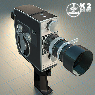

PS: 2 more of my babies: an H8 and an H16.
Sony NEX-VG10 AVCHD E-Mount Lens Camcorder-picture-11.jpg   Sony NEX-VG10 AVCHD E-Mount Lens Camcorder-picture-13.jpg
