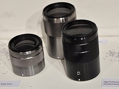

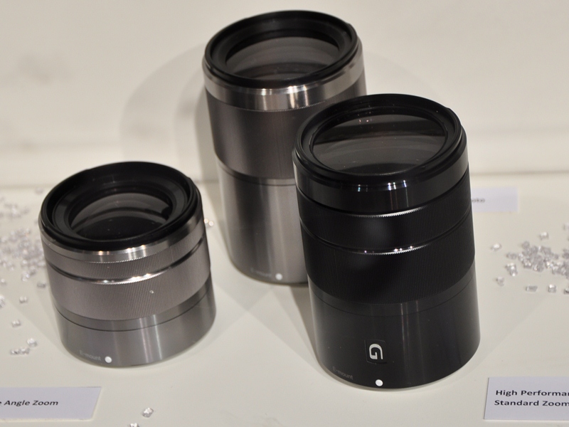

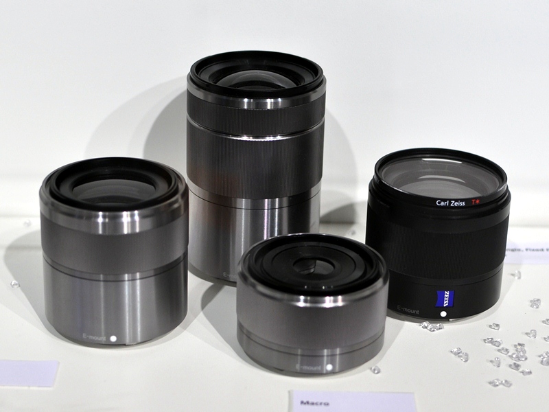

[photokina] Sony Unveils 7 Lens Units for NEX Mirrorless Cameras
Sept 27, 2010 16:51
The four interchangeable lenses to be released within 2011. A wide-angle single focus lens, single focus macro lens, single focus portrait lens and telephoto lens with the brand name of "Carl Zeiss."
A zoom lens, wide-angle zoom lens and single focus middle-range lens are scheduled to be released within 2012 under the brand name of "G Lens."
A flash unit is under development.
It will become possible to use the autofocus function with lenses equipped with an SAM or SSM motor.
Users will be able to assign the functions to change ISO sensitivity, auto HDR (high dynamic range) and aperture value to buttons.
It is important for SLR camera users to quickly change ISO sensitivity, etc.
It will become possible to shoot movies with an aperture value set for shooting still images. Currently, an aperture value is automatically set for shooting movies and cannot be adjusted by a user.
Sony Corp will launch seven interchangeable lenses for its "NEX" series of mirrorless cameras in 2012.
This was announced by Masashi Imamura, president of the company's Personal Imaging & Sound Business Group, at photokina2010, which is taking place in Cologne, Germany. Currently, there are only three interchangeable lenses that are compatible with the "E-mount," a lens mount for the NEX.
When Sony asked the users of the NEX about the camera, an overwhelmingly majority of them said that they want more lenses, said Toru Katsumoto, Sony senior general manager, Imaging Division 3.
Sony will release a wide-angle single focus lens, single focus macro lens, single focus portrait lens and telephoto lens under the brand name of "Carl Zeiss" within 2011. And the company intends to launch a zoom lens, wide-angle zoom lens and single focus middle-range lens under the brand name of "G Lens" within 2012. At photokina 2010, mock-ups of those lenses were exhibited along with a flash unit.
Imamura also announced that Sony started to consider disclosing the specifications of the E-mount to third-party manufacturers. Some manufacturers have already released mount adapters, and an increasing number of users are attaching the lenses of film cameras to the NEX cameras.
The specifications of the E-mount include mechanical elements such as shape and electronic elements that deal with signals. But the company has not yet decided to what extent it will disclose the specifications.
Sony will update the firmware of the NEX in mid-October 2010 and the firmware of the NEX-VG10 camcorder in mid-November 2010 to responds to the following user complaints, which were cited most frequently.
- When a lens for the A-mount is attached to the NEX by using the "LA-EA1" mount adapter, its autofocus function does not work.
- It is not possible to change ISO sensitivity, auto HDR (high dynamic range) or aperture value by pressing a single button.
- It is not possible for users to set an aperture value for shooting a movie.
MORE ABOUT FIRMWARE:
Here's a detailed list of the changes in this firmware update:
Adds a user-selectable option to drop you back into whatever menu item you had last selected, vs. always taking you to the top of the menu system when you hit the Menu button. (A huge improvement in usability; one that frequently had us gnashing our teeth as we fiddled with the cameras many options while testing the prototypes.)
Adds a user-selectable option to make the NEX menus wrap so scrolling off the bottom will take you back to the top entry again. (Not quite as important as the first change above, but this still removes an enormous annoyance.)
Adds customizable buttons: A gigantic improvement for experienced users. The center button and lower-left button on the camera's back (see illustration above) can now have a wide range of camera functions assigned to them. Sony reps at the press event didn't have an exact number for how many functions could be assigned, but said it was "a whole passel" -- potentially 20 or more. Configurable options include things like white balance, ISO, exposure mode, etc. The center button can have up to three functions assigned to it simultaneously, which can be selected by pressing multiple times or pressing and scrolling with the rear control dial. The lower left button supports just one function at once. Bottom line, you'll be able to have up to four camera functions close at hand, rather than having to delve into the menu system.
Sony NEX-VG10 AVCHD E-Mount Lens Camcorder-1.jpg   Sony NEX-VG10 AVCHD E-Mount Lens Camcorder-2.jpg
