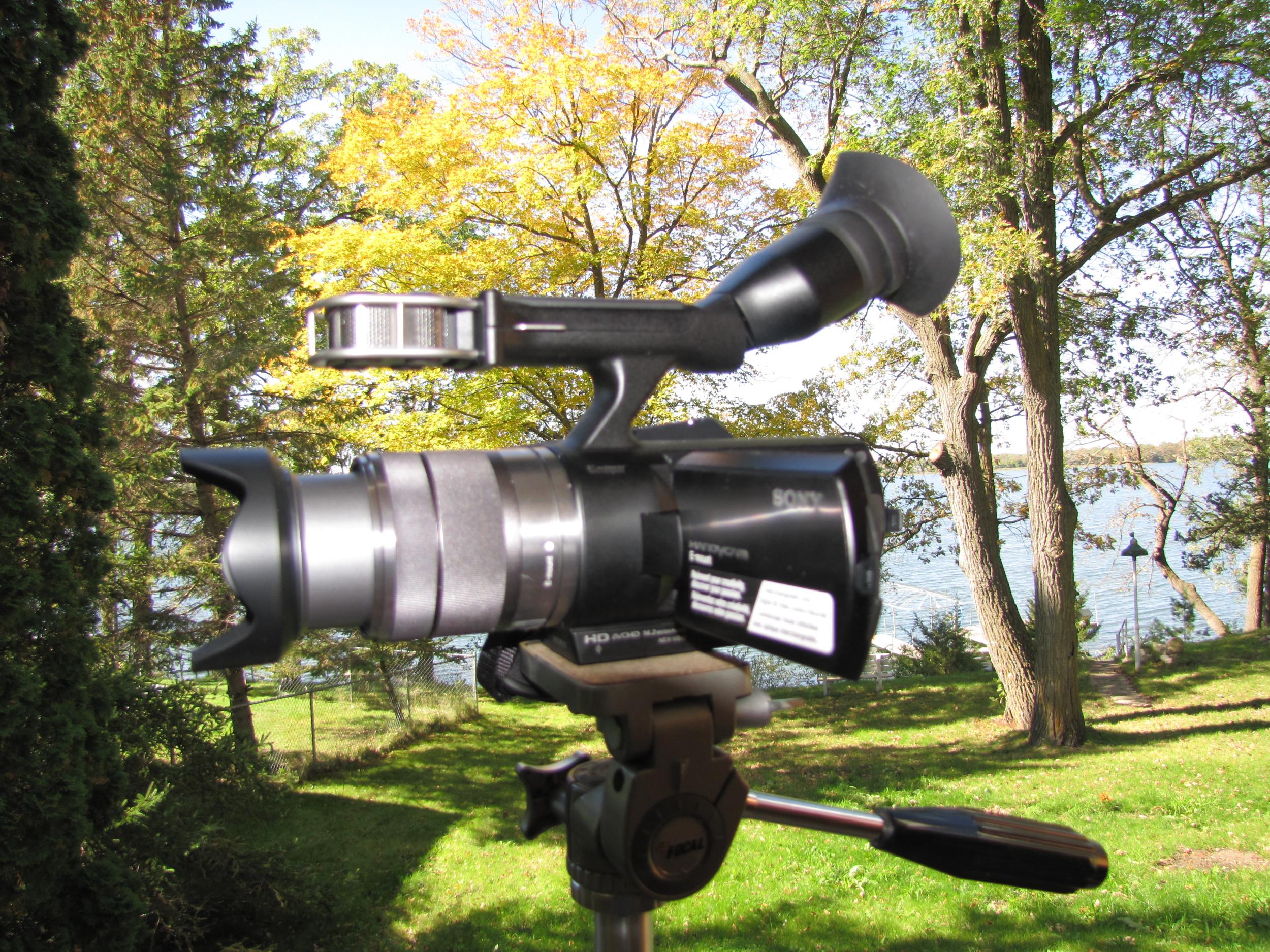

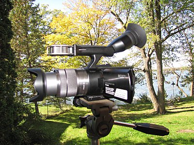

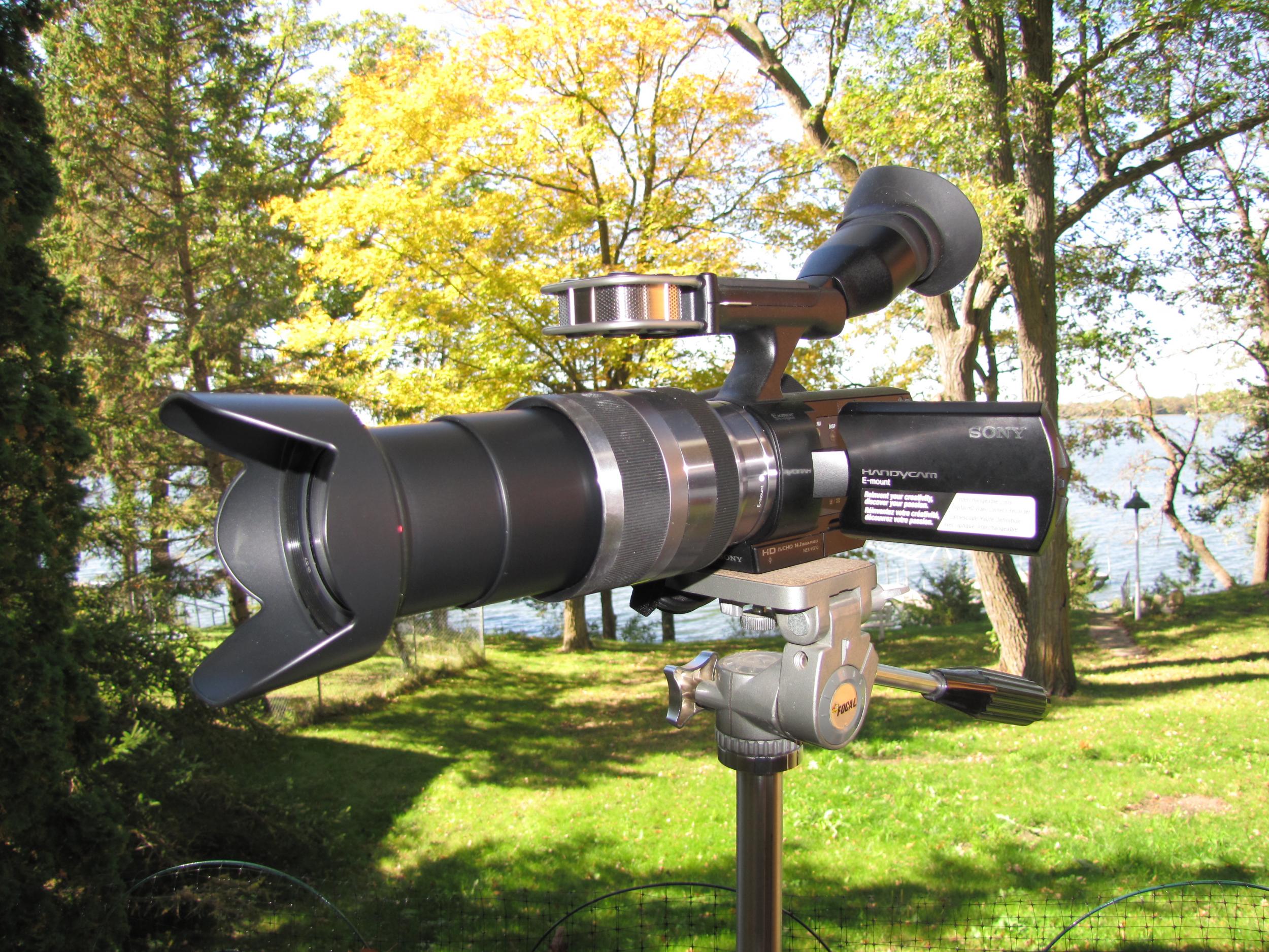

PS: Attached are 2 pix of the long and short zooms fully extended. You can see how much rotating the zoom ring must force the long zoom to move in and out.
