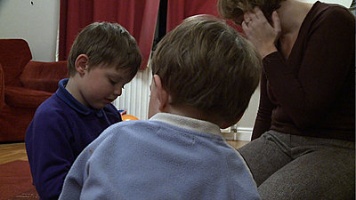

I played the mov with Mediaplayer full screen (1920x1200), and there's definitely a blue cast on the entire leftmost part of the screen, along the left edge, culminating in the upper left corner into what can be mistaken for vignetting, IMO.
Also, could you please post a grab of what you say is "grainy" at just 12dB, Paul? TIA!

The blue cast is there all the time though, and the error is not. As I said, I run 2 x 24" LCD's and the blue (rss news) screen saver is what was emitting the blue. There was more light coming from my monitors than any other light in the room.
Here's one of the hi gain images. I was in the middle of experimenting with shutter speeds though so you really shouldn't judge the camera by it. This is the shot where I noticed the lens problem too.
(excuse the cursor) :)

Thanks Paul for the grab; it's not that bad; the curtain and chair are almost grain-free, and this is the kind of object that becomes noisy very easily on my V1E (certainly at 12dB).
Frankly, if I were you and already have the camera, I'd keep it. Due to the shortages, they might not have a quick replacement for you; besides who knows how many other minor bugs will be surfacing in the nearest future! I'd keep and use it, as it can produce acceptable video (or at least use the time to master it). Then, after say 2-3 moths when hopefully everything is settled, I'd send it to Prime Support for a week to get the "vignetting" and everything else (should some more issues appear) fixed at once.

The effect mentioned is apparent but I wouldn't accept that setup as an adequate test in any way; you must have a subject of uniform brightness.

Serena, it's in his small video sample of footage of his family he posted. It's for real, that's for sure.

This is NOT a design short coming. This is a defective unit. If it looked like uniform vignetting I'd say it was a design issue. From the few other clips we've seen posted by others we haven't seen anything like this.
