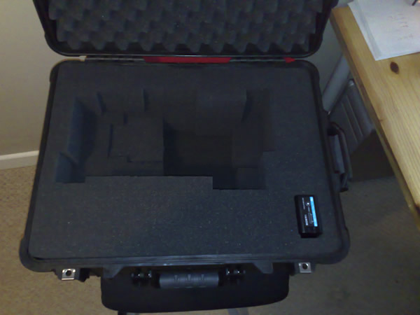

Old November 22nd, 2007, 11:41 AM   #70
Location: Norfolk, UK
Posts: 627
Hard time, isn't it?
Yup, left feeling empty...
Anyway, we're supposed to be professionals.... enough of this humor already!

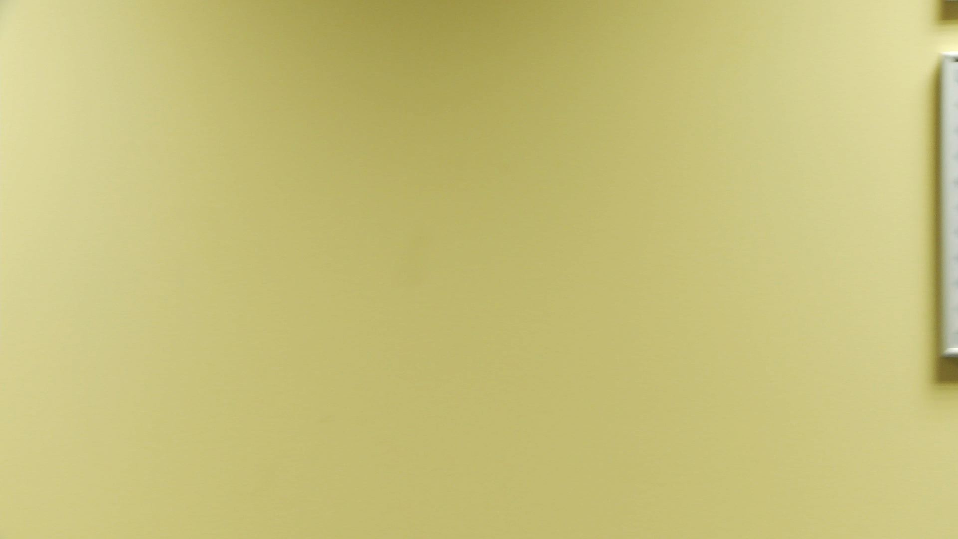

Got my hands on the EX1 finally today. Wow, it is lovely...the picture is astounding and that LCD screen?!? For 35mm adaptor work you won't really need an external monitor for focus with focus assist and expanded focus coupled with that resolution.
I tried to get the vignetting issues as described by Paul. I really struggled to find it. By pointing at a blank bright wall and zooming to around 10mm the worst I managed to get was this...you have to really look hard to see it. I see this as not a problem in the slightest.
