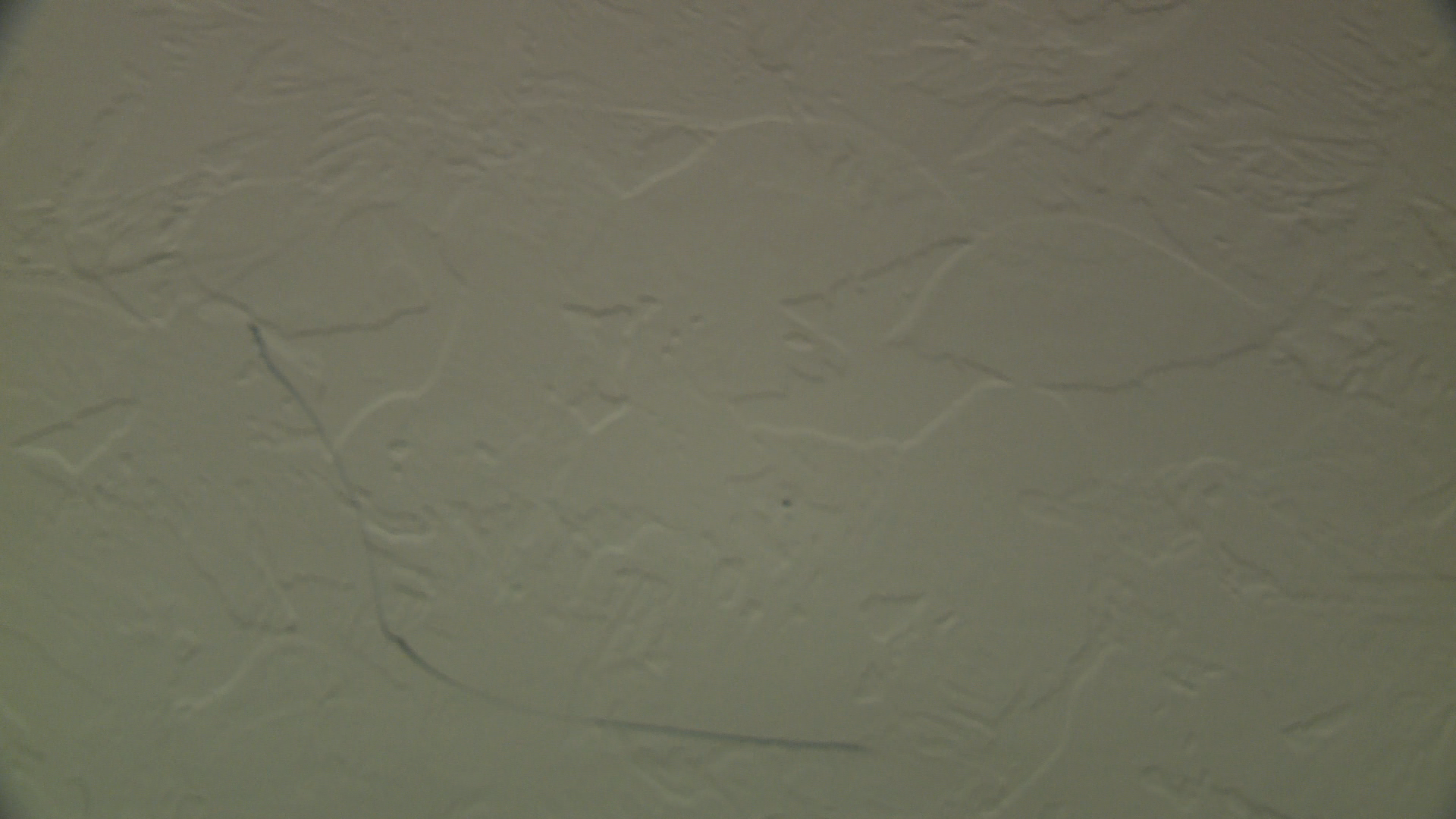

Old November 29th, 2007, 11:28 PM   #199
Location: Phoenix, Arizona
Posts: 81
OK. Here's what I got. #68... Looks like it has it at the end of the zoom.
Winston Ashley is offline   Reply With Quote
Are you saying 80mm ?
That's odd.
