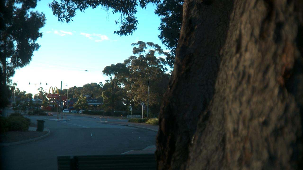

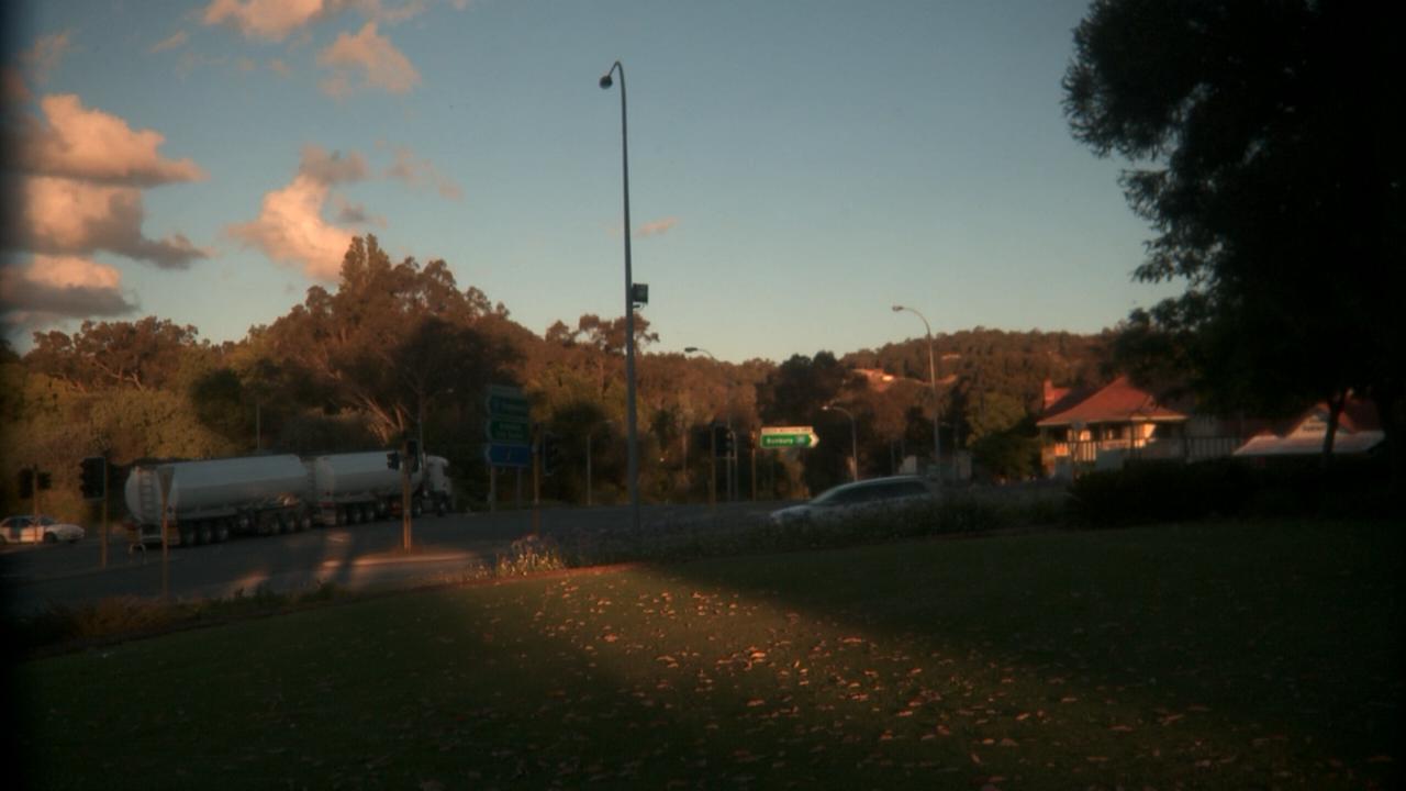

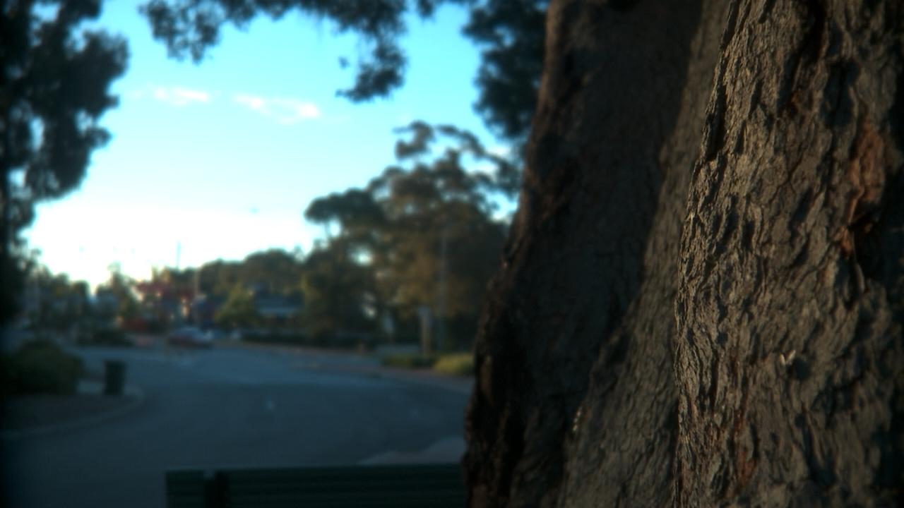

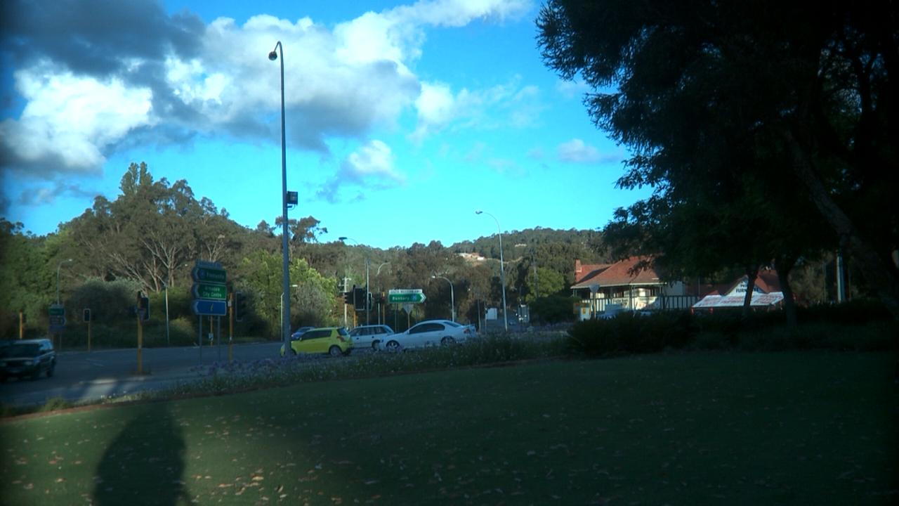

Truecolor v2 on pmw-ex1-letus extreme
I motivated myself to try the published true color preset published in this thread with an EX1 modified Letus Extreme and a Voigtlander f2 40mm prime lens.
I made an error and took a local whitebalance instead of going with a more normal daylight setting. One of the frames below is a grab from a shot done with a normal daylight preset.
There was also a piece of two f-stop neutral density filter gel in the path between the lens on front and the groundglass.
Frames are numbered :-
1 2
3 4
Frames 1, 2, 3, are local whitebalance to white card.
Frame 4 is daylight preset.
Frame 4 is most fathful to the look and colours at that time of the day which was evening just before sundown. It is not the sharpest shot. Focus with groundglass work must be meticulous, - no excuses for me.
I was also a little greedy with the relay wide-view and picked up an edge of the prism path through being zoomed back a fraction too far.
Here's a link to motion versions of those frame grabs :-
http://exposureroom.com/members/DARA...d6b3f40a2cadd/
Picture Profile Recipes-ex1trucolorv201.jpg   Picture Profile Recipes-ex1trucolorv202.jpg
Picture Profile Recipes-ex1trucolorv203.jpg   Picture Profile Recipes-ex1trucolorv204.jpg
Last edited by Bob Hart; December 9th, 2008 at 10:48 AM. Reason: mislaid words plus added link
