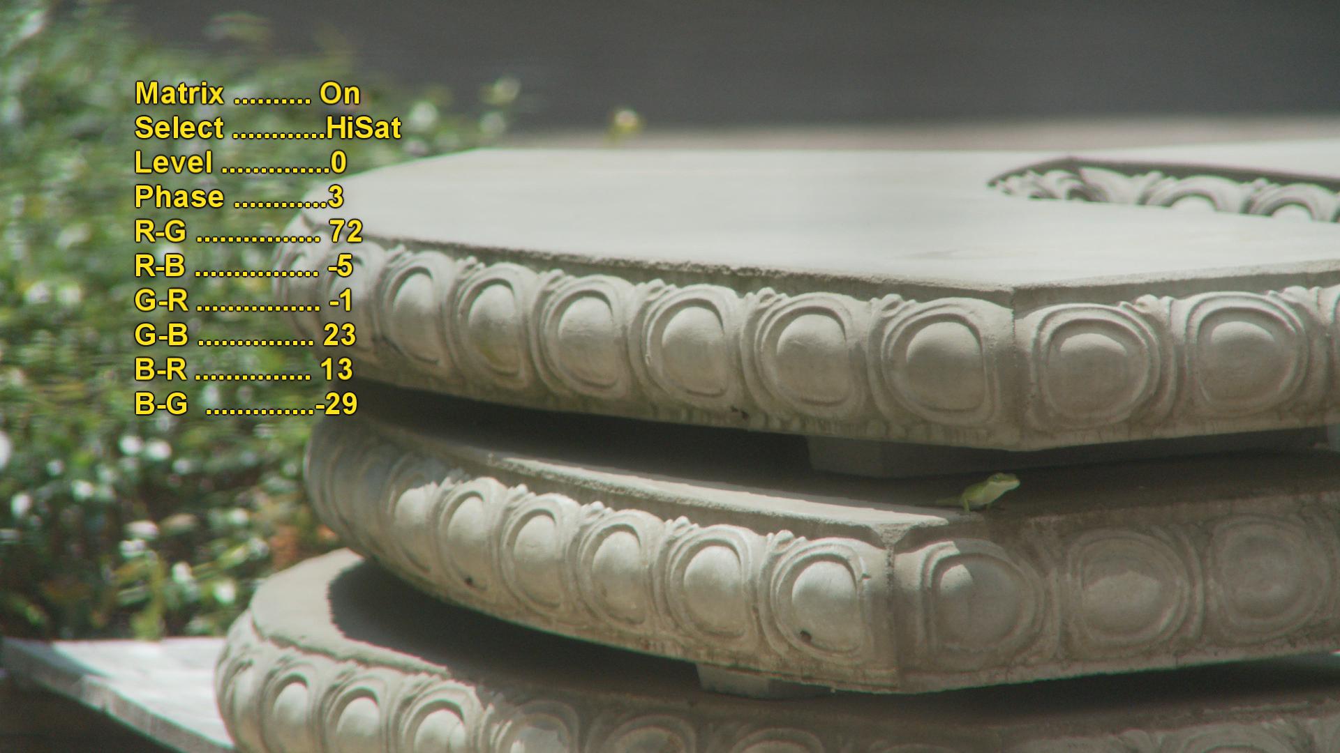

George,
Here is a sample shot with that RC1 profile you posted.
It was shot through the not-so-clean window of my office which overlooks the lounge area outside the building.

Perrone - Thanks for the still. Too bad there wasn't more color range in you subject. Let us see what some full color range subjects look like with RC1 on your camera.
Ronn - Great clip. Nice range of colors in the subject and moving in to frame to show skin tone is a plus. Very saturated without any strange colors that I saw. Should look great from 0 to -15. I had not thought about it before, but I will try a Tru-Pol on the charts to see if that upsets the balance or levels. Polarizers might want a profile of their own.
RC1 is about the max saturation I would be brave enough to use on a real shoot, and then for clients that insist on no post grading. It provides a bit of head space on saturation, but exposure or white balance errors could still give chroma clipping.
RC2 is to show where the top is, DSC 50% color chart taken all of the way to 50% on scopes. Pretty much no chroma head space left.
George Strother is offline   Reply With Quote
Yea, I'll provide something a bit better this coming week. It rained here today, so I couldn't really capture anything.
And I completely agree with you on RC1. I am probably going to shoot with it this week in an interview I have to do. We'll see how it works.
