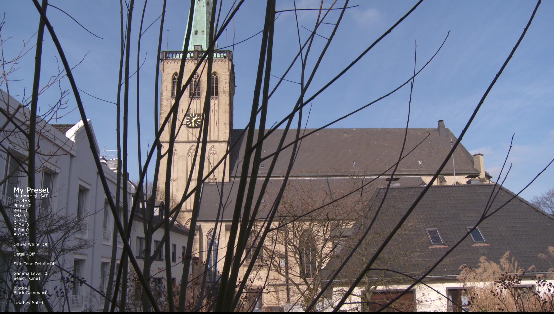

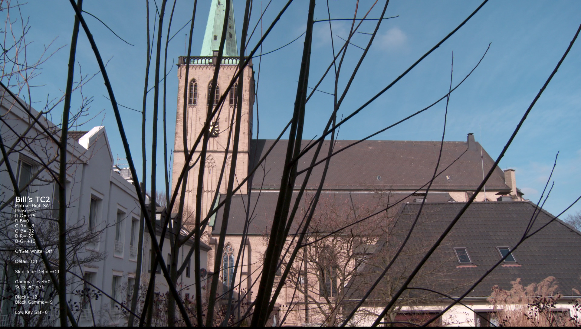

Hmm, I've checked again, because wheather is great today.
It seems that the picture looks more natural with your preset.
(reddish sky with mine, greenish sky with Bill's TC2 but it looks better)
Edit: why do these pictures look different when viewing in firefox?
My preset seems to produce more natural colors when viewing in firefox - strange...
Edit2: The MXF files look the same in VLC compared to firefox, but very different in windows live photogallery...
regards Dennis

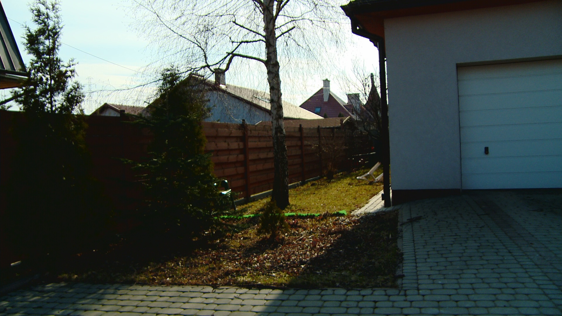

Old February 25th, 2008, 08:13 AM   #180
Location: Poland
Posts: 4,086
OK guys.

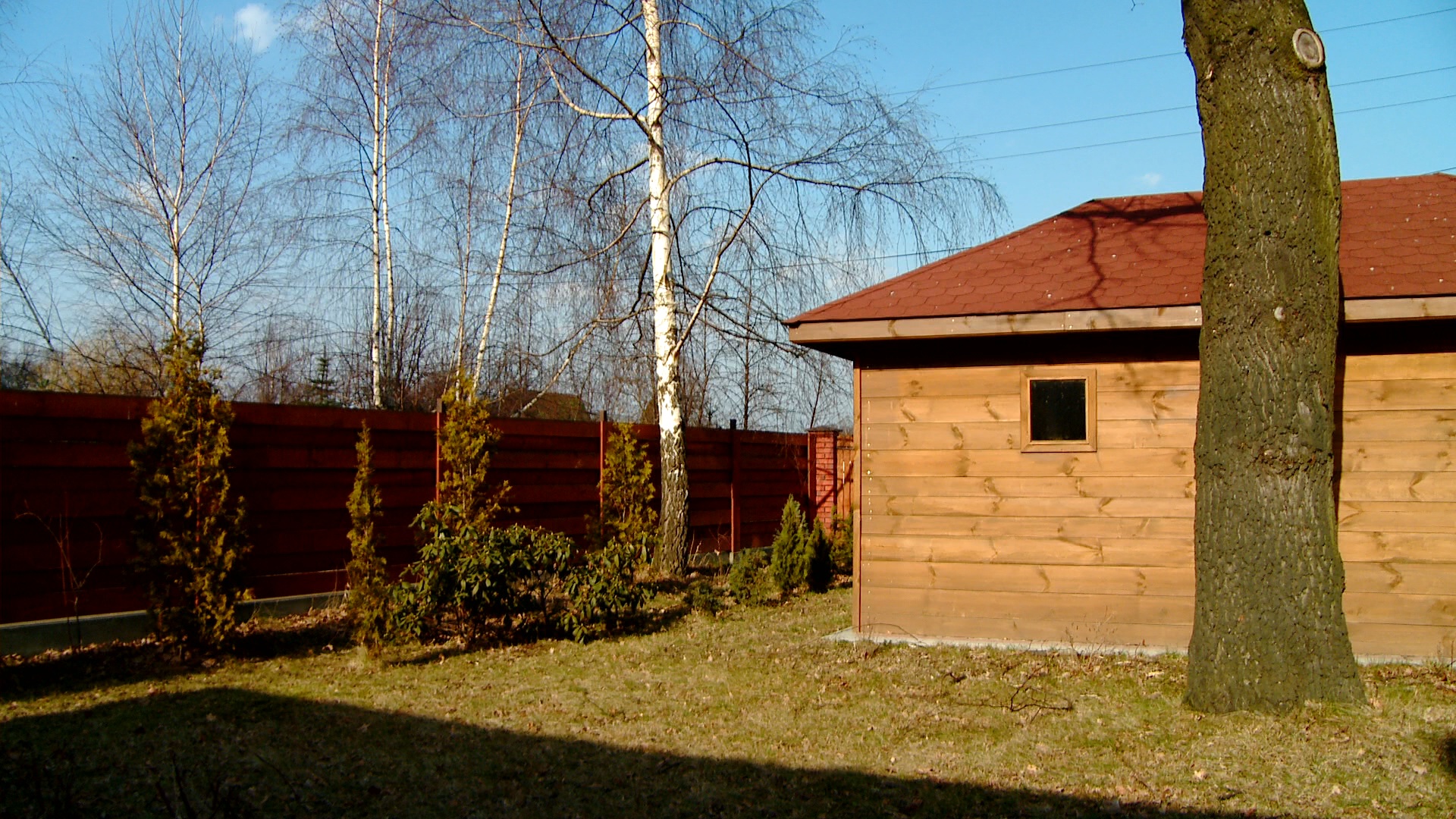

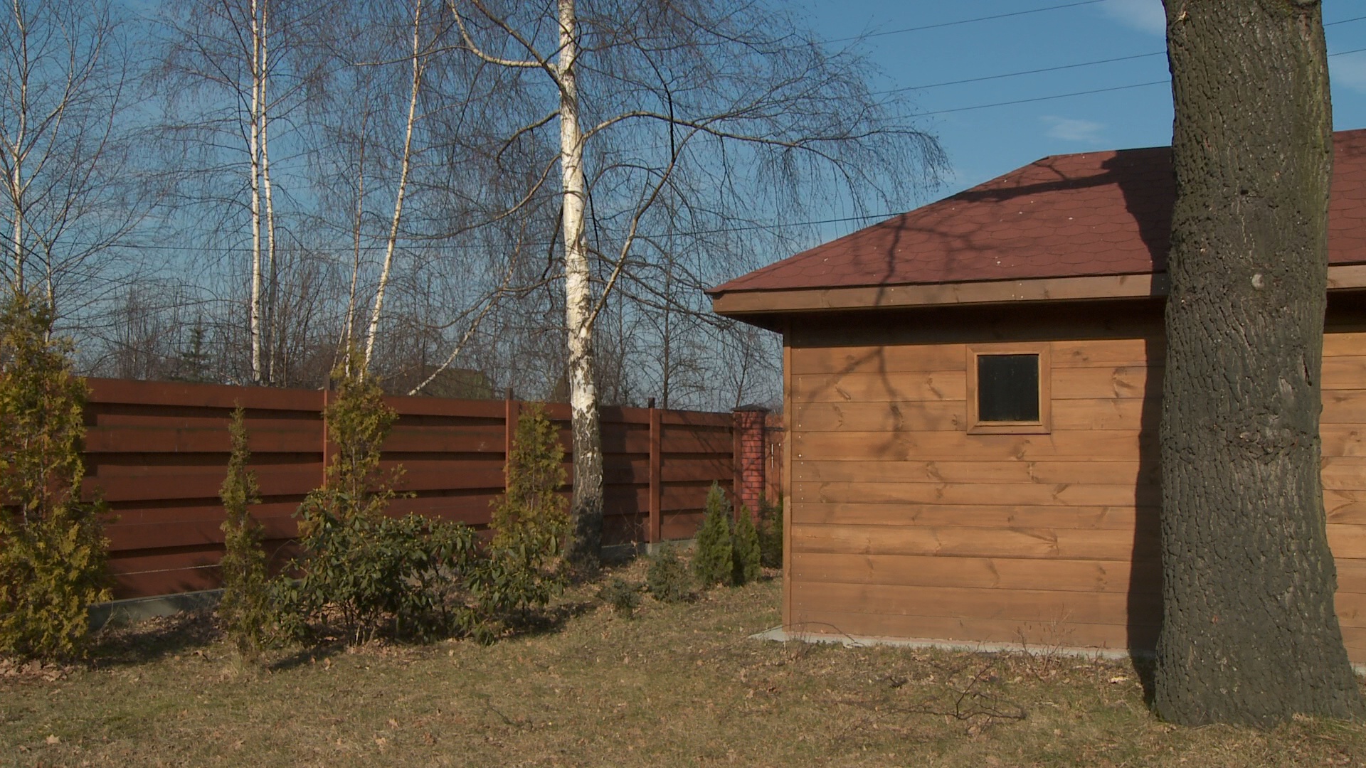

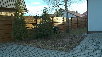

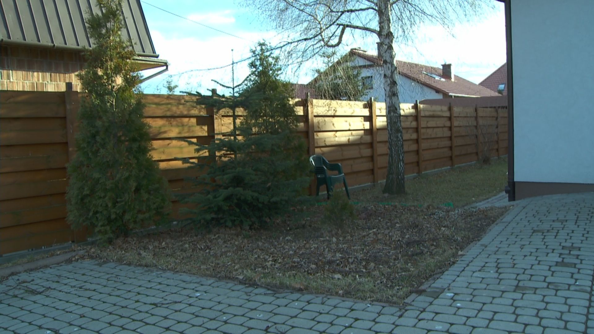

After some more testing, I must revise my understanding of what the philosophy behind both CINE gammas and CINE matrix is on this camera. Certainly, it's NOT the same I had on the V1, and thus NOT what I expected. Rather than more punchy/saturated than the STD gammas/ STD matrix, they seem to be muted and washet-out. BUT, given a second thought, do CINEmatic picture (as seen in the movie theaters) look contrasty? Not at all, so perhaps this is the CineAlta philosophy, after all? Low contrast, soft and saturated pictures...
Anyway, the two grabs below show a comparison of the same scenery using:
- Bill Raven's TC (or was it TC2), with Cine1 gamma on the left
- my new PP on the right:
gamma: STD1 level 0
matrix: Hisat level 20, phase 15, all colour pairs at zero (default)
Black: -25
Black gamma: -15
Low Key Sat: 15
As you can see, the STD1-based picture is much brighter and punchy than the CINE1-based one. What's more, this PP's knee (unlike that of CINE1) is not only adjustable (all defaults here), but even with default settings does NOT produce the awful "abrupt highlight clipping" as discussed in another thread, and mentioned by Adam Wilt (just see the extremely back-lit images at the bottom - the left one has been taken with Cine1 and shown in the "abrupt clipping" thread; see what I mean?).
So, the question is: to CINE, or not to CINE? - when one is after this punchy, contrasty and saturated look... Of course, the grabs on the right has been made too contrasty on purpose in order to prove my point; their blacks are too severely compressed for sure!
