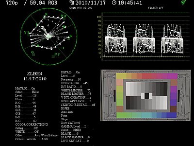

This is my EX1 setting to match my VariCam It is designed for post color correction to be shown on HD broadcast . This is for a scripted comedy. The camera was teched to a DSC chart with whites at 80 IRE and all settings on as was the VariCam. So this is how the is set up when I shoot. It seems whites expose at 78 IRE for good flesh tones.
ZLBH4
MATRIX…..On
Select……….HiSat
Level………..-26
Phase………..3
R-G…………95
R-B………….43
G-R………….31
G-B…………47
B-R…………..5
B-G………….82
COLOR CORRECTION
Setting………..Off
WHITE……….Off
Offset…………Auto White Balance
PRESET WHITE……6200
DETAIL…..On
Level…..-5
Frequency…..30
CRISPENING…..-45
H/V RATIO…..0
WHITE LIMITER…..75
BLACK LIMITER…..75
V DTL CREATION…..y
KNEE APT LEVEL…..0
SKINTONE DETAIL…..off
KNEE
Auto-knee
Point
Slope
Knee SAT level
GAMMA Level…..2
Select…..CINE1
BLACK…..-3
BLACK GAMMA…..0
LOW KEY SAT……0
Bob Hayes is offline   Reply With Quote

It's not the numbers
The numbers are pretty much arbitrary. The DSC chart doesn't lie. That is why I have included the waveform and vector scope. You can match a look by matching to frame grabs from a Waveform Vector scope. The downside is you need a waveform/vector scope. You need the cameras to be set up similarly. You are supposed to match VariCams in Video Rec, whites at 100 IRE. So you kind of need to know this info. This is why right or wrong I match my cameras on the mode I will shoot them in.
