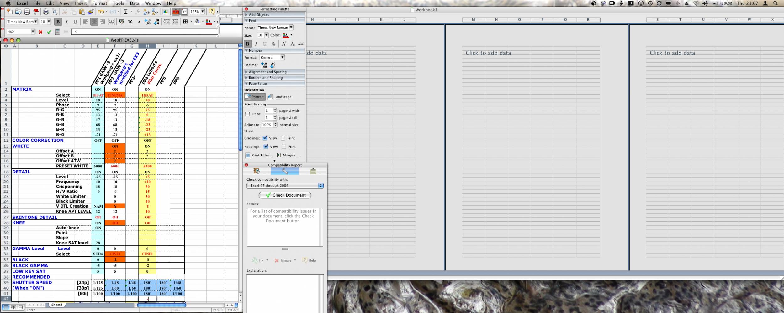

PP for EX3
Originally Posted by Wolfgang Winne View Post
Hello everyone!,
I would like to apologize to the person I took and used excel table from in this thread. I am so lazy and that excel table so well prepared I couldn't resist. I am sorry and I Thank you!
Wolfgang, Thank you for taking the time to post your findings too.
Wolfgang, I also took the liberty to transfer and post your settings for EX1R to the excel table first column in light blue. The second column in white is your settings modified (in orange) to fit my taste for EX3 and the fourth column in yellow is my settings for a film look on EX3. Please feel free to load them in your system and look at them in your vectorscope and if you do, please let me know what your conclusion is please.
Please, anyone, take a look at this settings and please comment. Feel free to try them.
Of course my film look settings for the White Preset will vary depend on the situation (indoor/outdoor/outdoor very bright/florescent/tungsten).
Thank you
Luben
Also, please try under Wolfgang's/modified Matrix, Phase 9 - change to -5... I like it much better, but forgot to do the column...

Luben Izov is offline   Reply With Quote

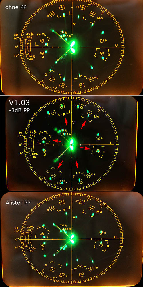

Vectorscop with colorchart
http://www.fxsupport.de/pic/2010/pp/14.jpg

Wolfgang you have done some really good work here using an interesting combination of settings. Must be nice to have scopes of that quality. I have been going through your website using a translation engine.
A few things I am unclear about. It appears you did some work on a profile and then revised it but it is unclear to me, if you have 2 profiles in development or if you are modifying just one profile and documenting the changes as you go. There is also a place where you use the "FL Light" setting instead of "High Sat" and so on. Do you recall why you went with "FL Light"?
Old June 20th, 2010, 11:49 PM   #553
Location: Bremen, Germany
Posts: 176
It's only one PP! The version 1.03 is current.

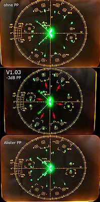

FL Light has the best color vectorangel on the vectorscop for my EX1R. Here a picture of 3 PP:
top without PP, my -3dB PP v1.03,
then this PP:
Matrix: On
Select: Cinema
Level: +35
CC: off
Detail: on
Level: -8
Frequency: +30
Crispening: +20
Gamma: +-0
Select: CINE1
Black: -4

Old June 21st, 2010, 12:16 AM   #554
Posts: 176
<Also, please try under Wolfgang's/modified Matrix, Phase 9 - change to -5... I like it much better, but forgot to do the column... >
Thats not correct!! You can not change the matrix from "FL Light" to "cinema" with my color value, this colorspace is very wrong!!!!
Wolfgang Winne

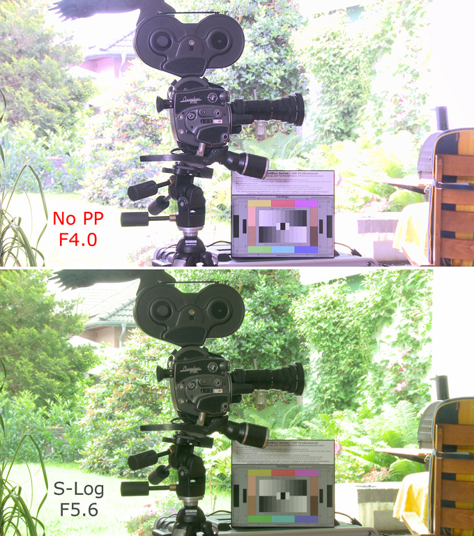

My new EX1R S-Log Picture Profil, see the attach picture (my second PP), +1 - +1,5 F-Stop
What is S-Log? Wide Dynamic Range, here the F23 Sample: YouTube - Sony F23 Camera
