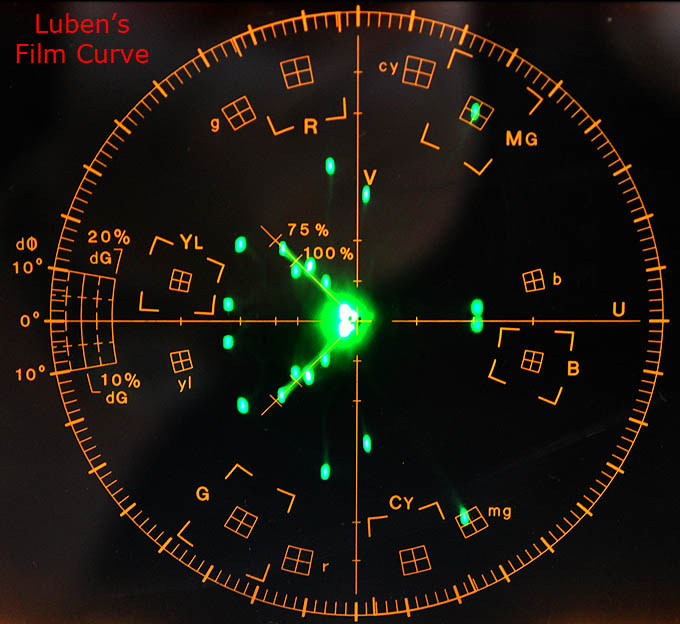

Luben's Film Curve (My EX1R with vectorscop and DSC-Laboratories colorchart.

Hi Wolfgang,
I appreciate your effort to get the best color and latitude possible, but....
- have you also considered the detail vs. noise factors?
Old June 22nd, 2010, 04:31 AM   #565
Location: Bremen, Germany
Posts: 176
<- have you also considered the detail vs. noise factors?>
Yes, calibrate on ISO 12233 Test Chart.

Old June 22nd, 2010, 04:37 AM   #566
Location: Poland
Posts: 4,086
Well, what I mean is your settings for Frequency and Crispening (also, Black/White Limiter).
Quite opposite to what has been long established as optimizing detail vs. noise, don't you think?
If you have investigated this thoroughly, I'd appreciate a more detailed explanation.

Old June 22nd, 2010, 05:01 AM   #567
Posts: 176
Crisping:
+ value = no details, no noise
- Value = more details, more noise
frequency:
- value = more details
adjusted optical from my sony flat screen.
