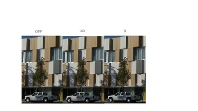

Thanks Eric! It sure looks like you're right about -40.
Thanks to your examples, I compiled a quick comparison from your images.
I wonder if -20 to -30 might be a good medium.
I had no idea -99 was this soft. Good to know.
Here it is:
Far left is detail off, middle is detail at -40, right is detail at 0.
Picture Profiles on the EX1-ex_detail_comparison.tif

Eric, thank you for the frames. Another option to consider, if one is going to post process the footage anyway, is to shoot Detail Off, then use an Unsharp Mask filter in your NLE or compositing app. You can experiment with this in Photoshop to see the effect. Zoom in and see the difference, there are a few parameters to play with for the desired effect. I stacked the Detail Off and Detail 0 frames, two layers, then toggled the top layer on/off after experimenting with Unsharp Mask filter parameters applied to the Detail Off layer.
For fast turn around projects, Steven, -20 to -30 looks to be a good medium choice. Good info, thanks!

Thanks Eric, those are very useful stills. I haven't gotten my camera yet, but i'll probably start off at -20 and then do further testing.
I don't do my own editing as I'm sure is true for many shooters here. I'm just a DP for hire. I can't afford to leave sharpening or color grading for some guy in post to screw up ( sorry that's my usual experience.). i need to give them the best picture I can 1st time.

Eric and Steve this is great info. For my taste and what I am seeing here detail off looks to work. I will try a few settings today and response in the sticky.

Thanks Eric for these examples.
The detail=off setting is by far the best.
Resizing and sharpening seems to work great with this setting.
The in-camera sharpening is much worse compared to what is possible in post (I'm in love with LimitedSharpen and avisynth ;))
