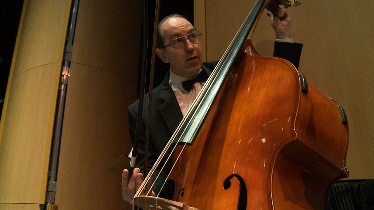

Originally Posted by David C. Williams View Post
The green vignetting usually happens when wide angle is used. If you zoom in somewhat as your concert shot is, you shouldn't get the green fringe. If you were setup on stage, you probably would have gotten fringing.
Here is a stage shot at full wide, to me an acceptable image in comparison to burgundy tuxes or brown and some black.
John Hamlik is offline   Reply With Quote

Originally Posted by Ben Chiu View Post
Thanks for posting the your findings, John. Can you tell us if you're using any of the picture profiles from the forum (like Bill R's)?
720/60p BBC Video setting stepped down 1/2 stop. 3200k preset for color temp. Still quite haven't figured out the best way to deal with downlighting and bald heads...
