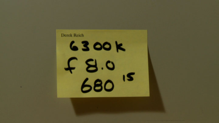

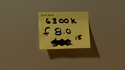

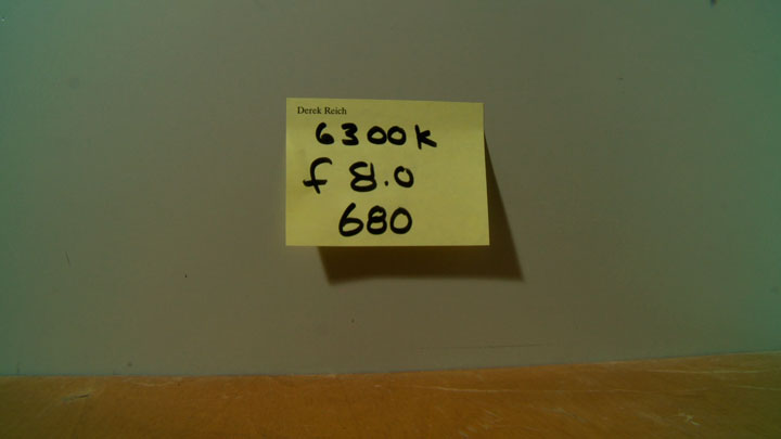

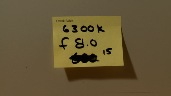

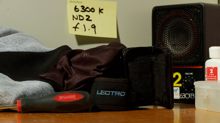

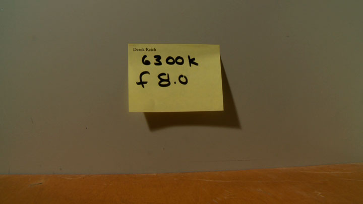

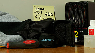

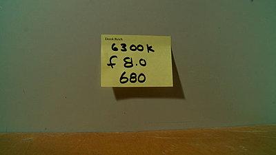

680 frame grabs part 2
Here are the rest of the grabs, and examples of the vignette
Filter for IR contamination-680test9.jpg   Filter for IR contamination-680test10.jpg
Filter for IR contamination-680test11.jpg   Filter for IR contamination-680test12.jpg
Filter for IR contamination-680test13.jpg   Filter for IR contamination-680test14.jpg

I would like to comment on the green vignette issue. I too did a similar test like Derek and pointed the camera to a white wall. The vignette is alarming when observed in this way BUT in the real world, unless you are not filming a very pale plain background, the vignette is much less visible. I'm not saying it does not exist but it might be very easily missed by the client especially in event videos where the shots are usually short and change frequently and the shot consists of other eye catching moving images.
Also remember that if the resultant footage is seen on 40" or bigger screens, the eye will have to travel from the centre to the edge of the screen to really notice the vignette.
I'm not happy with the outcome but in the absence of any real alternative and in view of the horrible blacks being produced by the EX series, I must say that the 486 / True cut 680 is a must have for the time being for any EX camera owner.

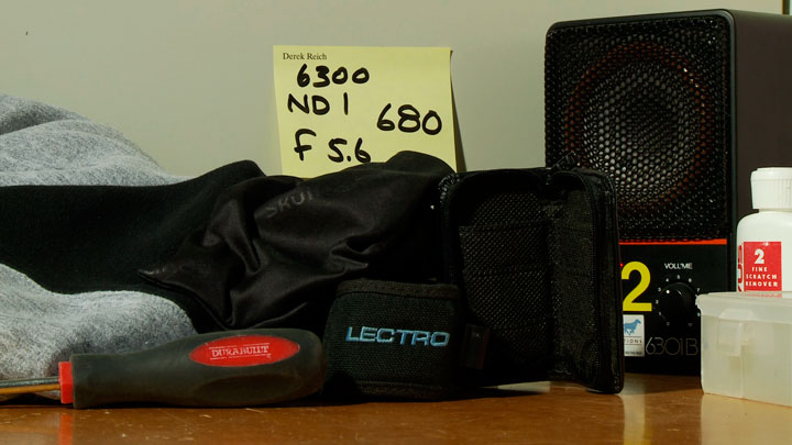

Good news from Ryan Avery at Schneider. The Tru Cut 680 will be marketed as a solution for the IR issue with the EX cameras making it much easier for the filter to be obtained.
Schneider acknowledges that at full wide there will be a green/cyan vignette, but as many have found this is just not that noticeable unless against a light neutral background, and I have found zooming in to just 15mm will make it completely disappear. I personally feel the vignette is much less objectionable than the blacks going magenta anyway, and this filter only needs to be used when the IR issue is present. It is not a filter to leave on the camera all the time.
I also noticed I neglected to add one of my frame grabs.... the 6300K no ND with 680. Somehow I missed that grab, but the 680 worked perfectly in that shot as it did with all the others. (who'd want to shoot at f16 with an EX anyway?)
This filter really does the trick..... and no need for multiple filters to have to deal with it. No light loss either.
it's nice to be back in the black.
www.zooprax.com

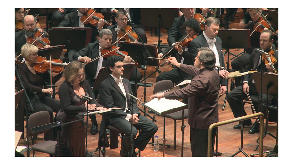

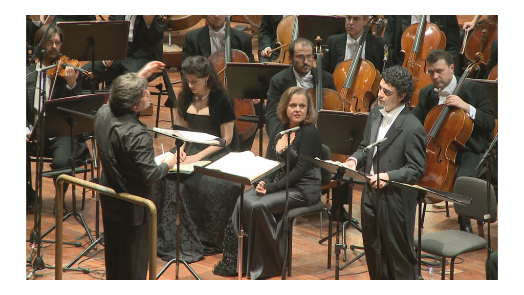

Here's a horrible example of how the EX1 behaves with standard lens and how a 486 instantly fixes a very nasty problem.
The materials which really suffer are man-made "silk look" products, the lapels on the male singer, but mostly the conductor whose shirt was black, as well as various other parts of suits and dresses.
Paul
Filter for IR contamination-486-filter.jpg   Filter for IR contamination-without-486-filter.jpg
