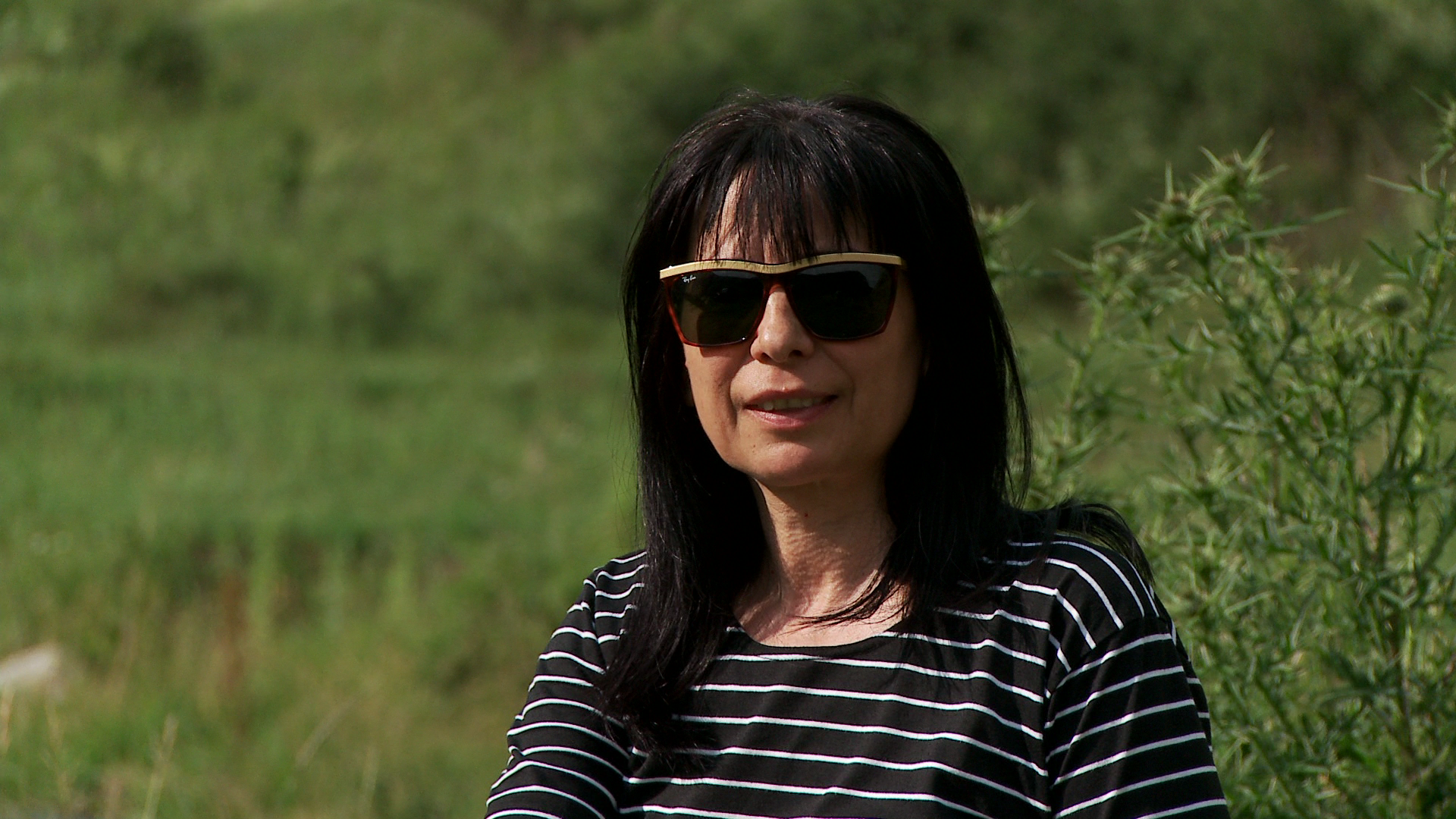

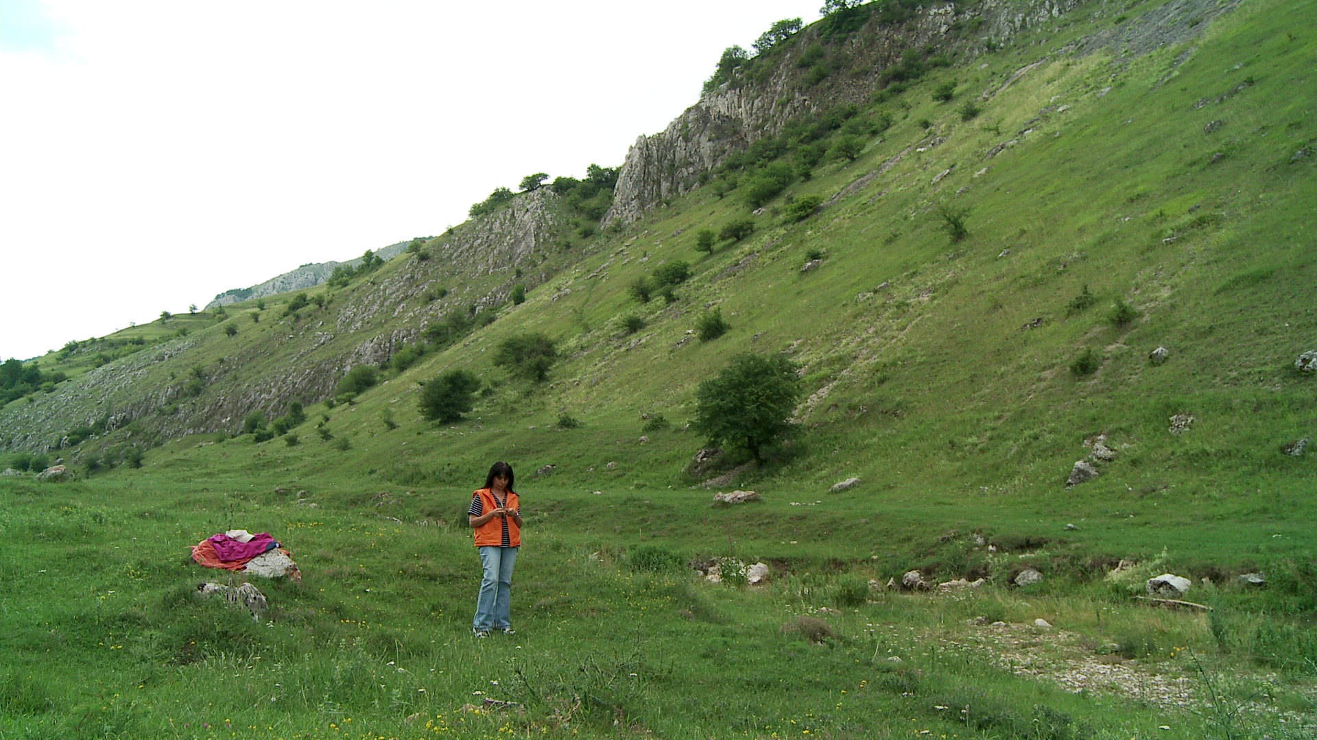

I made a new test with the filter 486 applied to EX1.

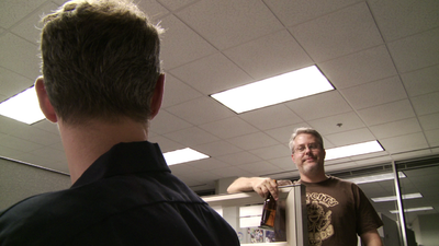

Another example of green
In case it helps, I've attached a frame grab from some footage that I shot recently. Please ignore the terrible lighting (or lack thereof) and exposure. :)
This was shot on an EX-1 at a fairly wide zoom, if not fully wide, because I couldn't get any further behind the foreground actor - I was sitting on the desk behind him as it was. Having read this kind of information before, I keep a 486 on my camera at all times, just in case. If/when I get to the point of having lens adapters, I'll deal with the issue again at that point, I'm sure.
There's another shot that I did that day fully-zoomed that showed a non-colored vignette when the camera moved (it was a hand-held shot), but I'm not sure that's a related issue - I'll probably try to reproduce in the future and narrow down the issue to the 486 or just something inherent to the lens on the EX-1.
The green is clearly visible on the right side on the ceiling tiles and also contaminates the dark blue on the left shoulder of the shirt in the foreground.
This shot is completely uncorrected off the camera - I've done some contrast/red-tint primary correction for this shot in After Effects - and I'll probably put an additional color correction, masked with a large feather, to get rid of the green on the edges, prior to the primary color correction layer. Had I not been doing color correction in AE, it would have probably been more of a pain, although since I'm using Colorista I probably could use it's masking features as well in something like Final Cut.
Hopefully this helps a little bit - at least to show people an example of the green with the 486. If people are interested, I'll report back with the results of a masked color-correction to the green so you can A/B the results. Just let me know.

Most probably you did not need to put on the 486 at all since from the attached frame grab it seems that you were working under neon light. I never had problems with such light - it's the halogen and tungsten (and natural sunlight) that produce the problem.

Posts: 120
To be honest I hadn't thought about it - I have the 486 on there all the time right now as I'd rather be safe than sorry - my belief is that fixing the green vignette, if it shows up at all, is much easier than fixing the IR contamination if I forgot to put on the 486.
Your point is noted, though.
But if I had taken it off, I wouldn't have a nice example to work on to see how the correction works and wouldn't have anything to share on the board! How tragic would that have been?!? :)
I think you meant to say "fluorescent" light and not neon.

I didn't even catch that myself - I read it as "fluorescent". :)
It's been a while since I had researched this, but if his original point was correct, it's pretty much any type of light other than fluorescent that would potentially create this problem for the EX-1? Makes the green cast of fluoro bulbs seem like a Godsend at this point, doesn't it? :)

As far as I know the problem only shows up with tungsten and sunlight. You shoud be quite safe with fluro, LED and HMI lighting.
