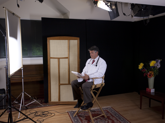

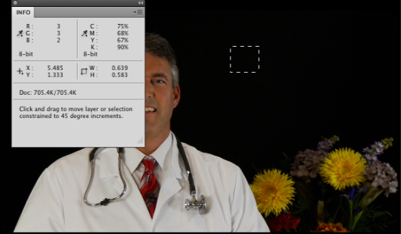

I don't Know why' but I don't seem to have a huge problem with Blacks in my studio.
I use a fairly inexpensive black felt backdrop stretched very tight over a wood frame.
Frame below is from a shoot yesterday. It is lit with a combination of florescent and tungsten lights, with careful control of spill onto BG.
It is shot with an EX3, there is absolutely no red tint in the blacks. White balance was with a pure white card, not a warm card.
I put the frame into PSD to check balance in blacks with eye dropper, from an export out of Color. No correction applied.
I know that if I spill tungsten light onto fabric I will get warm blacks.
So in my opinion if lit well there is no problem with red shift in blacks at least in my studio.
The shots below show frame, and light setup. There is also a softbox just to the right of the camera that shot photo.

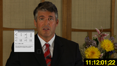

Here is a frame grab from FCP in PSD with info tool.
We shot him in suit as well.
Go figure I don't see any overly red. Maybe it is just my PP. I am using a UV filter but that is it.

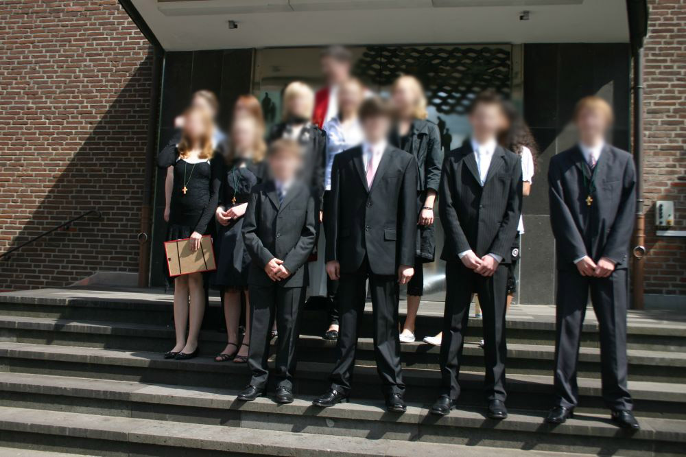

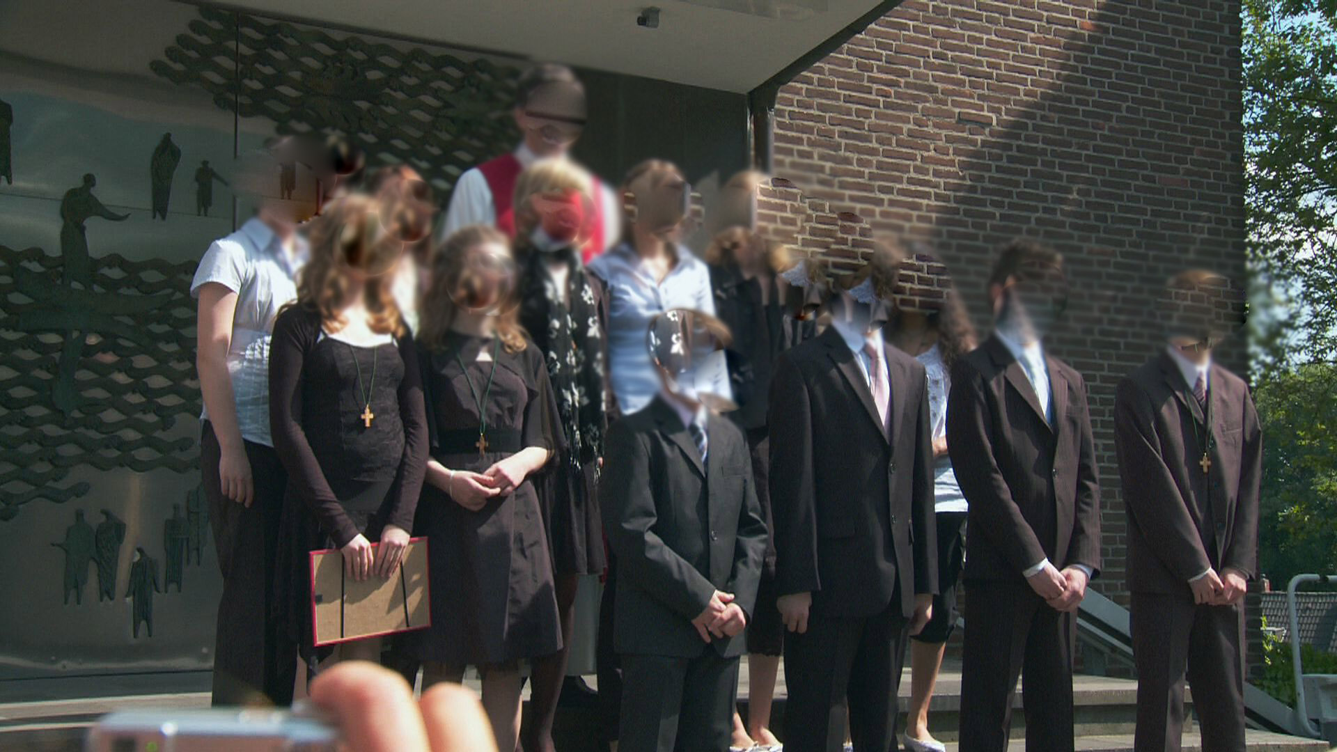

Here's a variety of fabrics. The neutral colored pic (IMG_0039.jpg, right hand side) was shot with a CANON SLR, the other one with my EX1. It shows drastically, that certain fabrics reflect a huge amount of IR-light.
I always use a UV-filter, I do need another one.
Rgds, Eva
