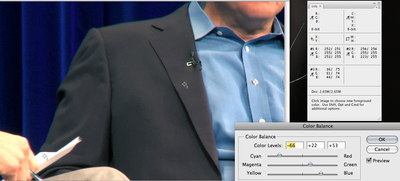

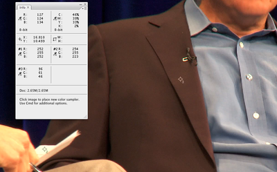

Originally Posted by George Griswold View Post
GRAY SUIT TURNS BROWN. Major convention footage shown here ... mixed lighting with tungsten and 5600 sources. Daylight preset balance (also tried setting WB with same result) Luckily client speced the EX-3... what would I do if I pitched this camera and this happened?
I have shot for two days with no color shifts before this one. I am now wondering if certain fabrics react differently (cotton, wool, etc.). I was thinking that this problem was infrequent and overblown-- not any more. I will review all 20 pages of this thread, but I think if Sony does not offer a "patch" that class action litigation may be in order. In 25 years shooting broadcast video I have never seen anything this extreme. Yikes! The old Ikegami never looked like this. I guess I have 486 filter in my future.
I just looked at your clip. Looks pretty bad if suit was gray.
But look at the skin tone.
I took a still from your video and analyzed it in PSD with eyedropper, 1st image.
And then I used Eyedropper points to white balance by numbers only in the Highlights, second image.
You will notice the skin tones are also much better when numbers balance.
It is really hard to mix Tungsten and Daylight, in a situation where you don't control lighting this is almost impossible. Where do you put white card. I sometimes find as little as 3' makes a huge difference.
The only way to fix this stuff is in post Color or similar.
I just played with image in PSD, the numbers are interesting though. I used technique I use for stills scans or digital photos.
Pick 3 points and adjust color balance until numbers check out even.
In this shot I would probably also desaturate a bit. Some of it is also a little blown out. I know you could make it look really good in Color.
Look at the adjustment numbers they give you a good indication of where problems lie. Mostly not much blue.
Filter for IR contamination-uncorrected.png   Filter for IR contamination-balanced.png

Old July 18th, 2009, 07:44 PM   #292
Sponsor: Westside AV
Posts: 1,365
Originally Posted by Ed Kukla View Post
olaf
you got the suit grey but I liked the flesh tones of the brown jacket shot MUCH better
I was not trying to make the shot look great I was just applying white balance.
I think the skin tone in the corrected shot is truer (maybe not nicer), when you wear a blue shirt. The shadow under your chin will be bluish. And the backdrop was blue, this would produce a bit of blue spill around the edges of face, and hands.
If you really color corrected this shot you could apply secondaries to any number of different elements or colors to achieve any "look" you want even warm skin tones and true blacks and grays.
The main point I was making is you cant judge a shot that has improper white balance, and blame it on your camera. You can it fix in post, when it is not possible to set properly when shooting (always the best option).
