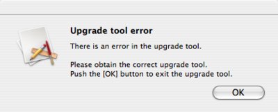

Old March 12th, 2010, 06:01 AM   #104
Join Date: Jul 2003
Location: italy
Posts: 172
I have a powerbook g4 1.67 Ghz running Mac os x 10.4.11. Downloaded the .zip file, expanded, version up tool won't open. Message says: Upgrade tool error.
I did download again, and again, no way. What's wrong?
XDCAM EX Firmware Updates Available-upgrade-tool-error.tiff
Pietro Jona is offline   Reply With Quote
Old March 12th, 2010, 06:08 AM   #105
Sponsor: Westside AV
Posts: 1,365
Pietro, it may be that you need an Intel mac. G4 is fairly ancient. And 10.4 pretty old system. I think you need 10.5. Maybe it is in Sony's notes somewhere or someone here may know.
If possible fiend a colleague with a newer Mac or PC and see if she/he would let you do the update using their computer.
