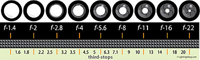

For those interested in lens ramping and maximum available iris, I found the following f-stop chart with 1/3 increments. very handy for figuring out what lens will allow what available light if you have a test clip showing several cameras at the same gain and f-stop.
So in the YouTube video below, you can see the PMW200 is much brighter at 18db gain, but this test is useless, because the X70 is set to f2.8, the PMW200 to f1.9. According to the f-stop chart, if you match the PMW200 to the X70's f2.8, your looking at slightly over 1 stop (6-7db) of sensitivity loss, and add to that the X70 will go UP another 15db! If you factor in that both the 70 and the 200 loose 1 stop at maximum telephoto, they may offer the same low light performance staying in the optical zoom range.

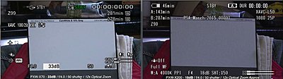

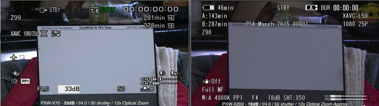

Here's an indoor test of the X200 vs X70, I'm loading the outdoor test to one drive for you.

Posts: 1,559
Re: X180 or X200, trying to decide
That's perfect Rob! Gives a bit of a base for comparison. According to the test shots, the X70 matches the X200's maximum 18db of gain at 24db. Roughly a stop and a half more sensitive on the side of the X200. That would make the X70's sensitivity around f8@2000 (PAL), or roughly equivalent to an old 1992 Sony BVW300A Betacam. I am basing that on the Sony X200 listed f13@2000 (PAL) specifications, and an f-stop chart.
This would make the X70 9db faster at f4.0, the aperture you are stuck with from 60% zoom 7x (60%) higher. The X200 can open up to f2.8 at it's maximum zoom, so it gains back an extra 1 stop, 6db. At wide angle, the X200 gains yet another stop (f2.8 to f1.9) , 6db, but the X70 gains a stop f(4.0 to f2.8) going wide as well.
If my brain math is correct, that would put the X200 at a 3db advantage at wide angle, and the X70 at a 3db advantage at telephoto, but that X70 advantage would be nullified as I am sure the X200 ramping would allow a bit bigger than f2.8 around it's 12x mark. For anyone looking at the JVC HM200, it is listed as f5.6 (NTSC), if that is correct, it would be a stop faster (f1.2) than the X70 at wide angle, but two stops (f3.5) slower at the identical 12x. Imagine an X70 limited to 18db gain!
The X70, X180, and X200, all seem to have a 1 stop loss from wide to full telephoto. I was afraid of the limitations of 18db gain on these cameras compared to 33db on the X70, but this makes me feel much more comfortable, the X70 needs that gain just to be able to see in sunlight. :)

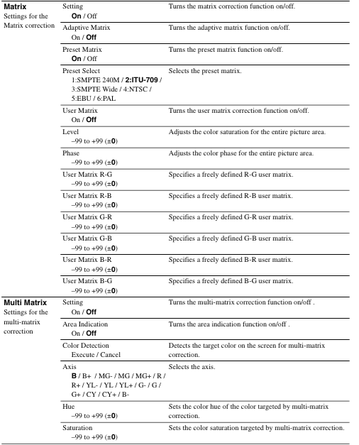

I found the X70 to be uncorrectable, you could make a color, maybe two, better, but full correction is beyond the scope of the current firmware menu settings. Also, my broadcast engineer tech scoped my X70, and told me my black balance was green. I told him the camera doesn't have a black shading function. He seemed a bit shocked.
I just ordered up 2 32GB SxS-1 cards and a USB 3.0 reader for $600, yikes! So basically, I am pushing myself into an SxS camera by force. Below is the available matrix correction menu items per the X180 manual. Not sure what multi matrix is.....my X70 experience would tend to make me think "hey, you get to adjust a second color along with the first one, that's two colors!" :)
