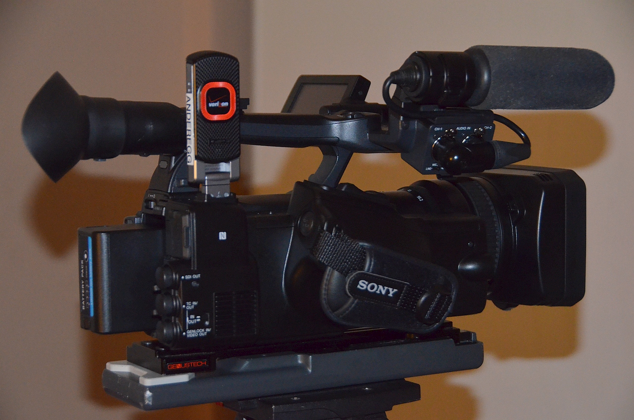

My new baby is ready for live news broadcasting now. The Genustech VCT14 adaptor fits just right, and the USB modem connector is a massive improvement over the X180. Oh yeah, that is my Panasonic AG-MC700P short shotgun microphone with OEM windscreen. Going to replace it with a Sanken CS3e soon. That will ruin the uncomplicated ergonomics, but vastly improve the audio.
