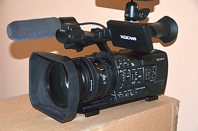

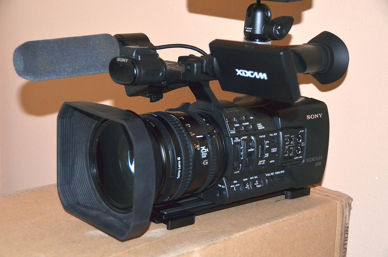

Join Date: Jan 2013
Posts: 1,559
Re: X180 or X200, trying to decide
Here is my new baby ready for battle. EXII 0.8x converter and Neewer CN304 3200k LED mounted on the back of the handle, balances out perfectly. The tripod adaptor on the bottom allows me to swap this camera onto any standard VCT14 style plate, very convenient. The thing must weigh close to 10lbs now......I need to work my arms out, or I won't be able to operate this camera very long! Good news is, the tripod adaptor makes a handy hand hold with the back of the camera braced against my shoulder, something I could not do with the X70, so it really isn't that horrible.
Also found that I can live stream 1280x720 3Mbps, and that Watson BP-U30 batteries DO NOT display in the viewfinder of this camera, have no idea my time remaining till empty. :(
