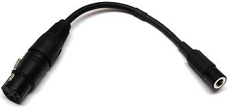

Hey Alister,
Would you mind providing a link to a power cable like that? I've found one that would work using the D-Tap connector to XLR but I've not found one that would use the EX1 pigtail on the battery.
http://www.LandYachtMedia.com

Alex Dolgin just started making a cable for EX charger or swit batts to 12pin .
Right now its 6" but I'm going to check for him if that is ideal
Off hand I'm thinking maybe shorter is better because if I use swit batts and the Sony charger I could keep the pigtail on all the time.

Hey Alister,
I've got a couple of these; (second product down)
Product Listing Power Sources
plug your Swit pigtail cable in and keep the D-Tap connector open for powering things like Nano Flash or monitors.

Perfect Bruce, Thanks!
