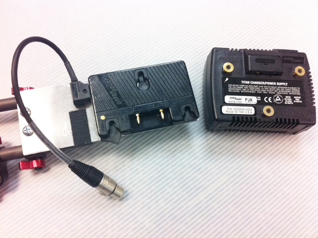

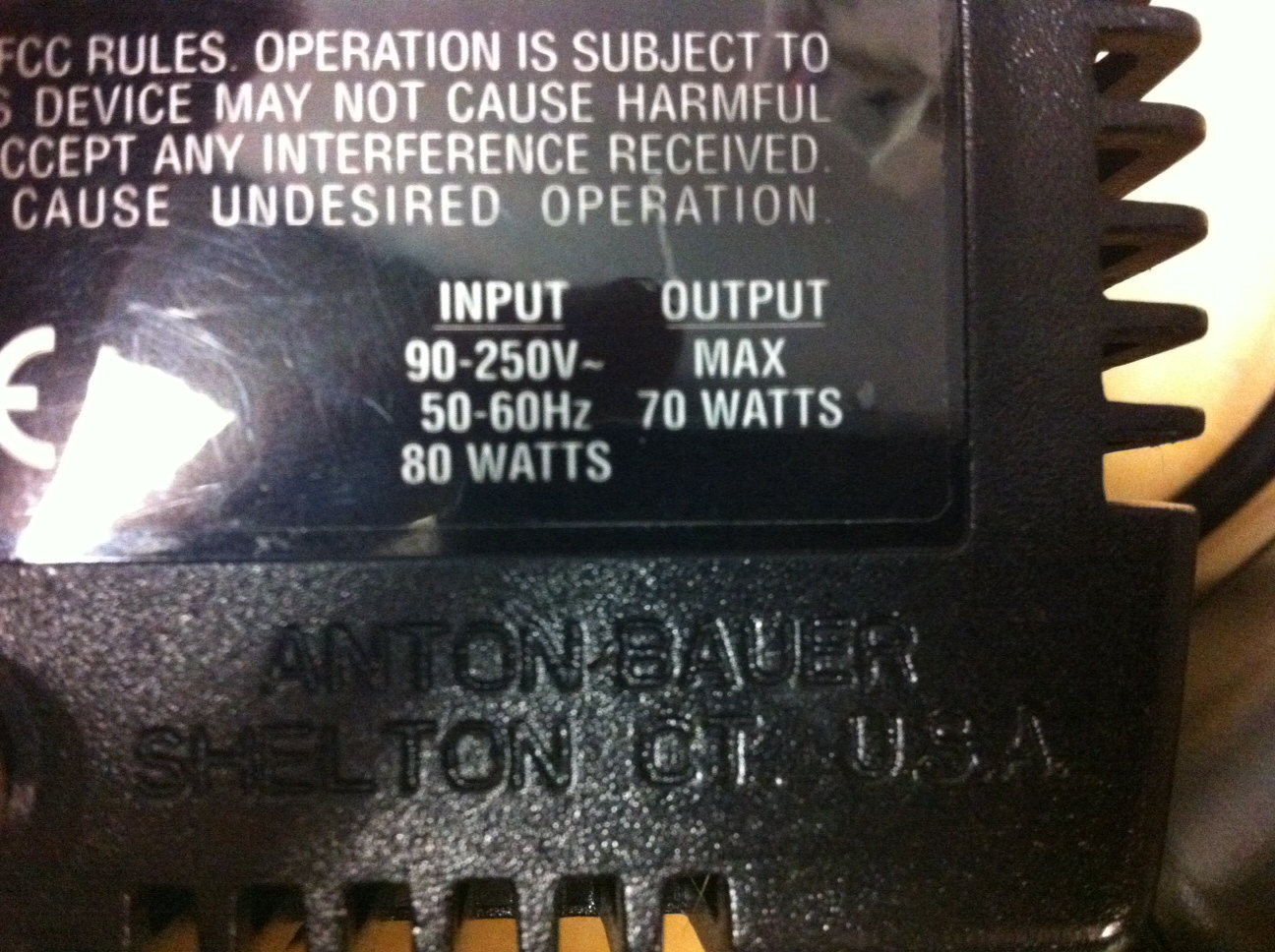

I use a Anton Bauer battery charger on my lite panels 1x1 for 12 volts DC out. No reason it can not function powering the camera as well with a D-tap and XLR power plug.
Regards
Steve
