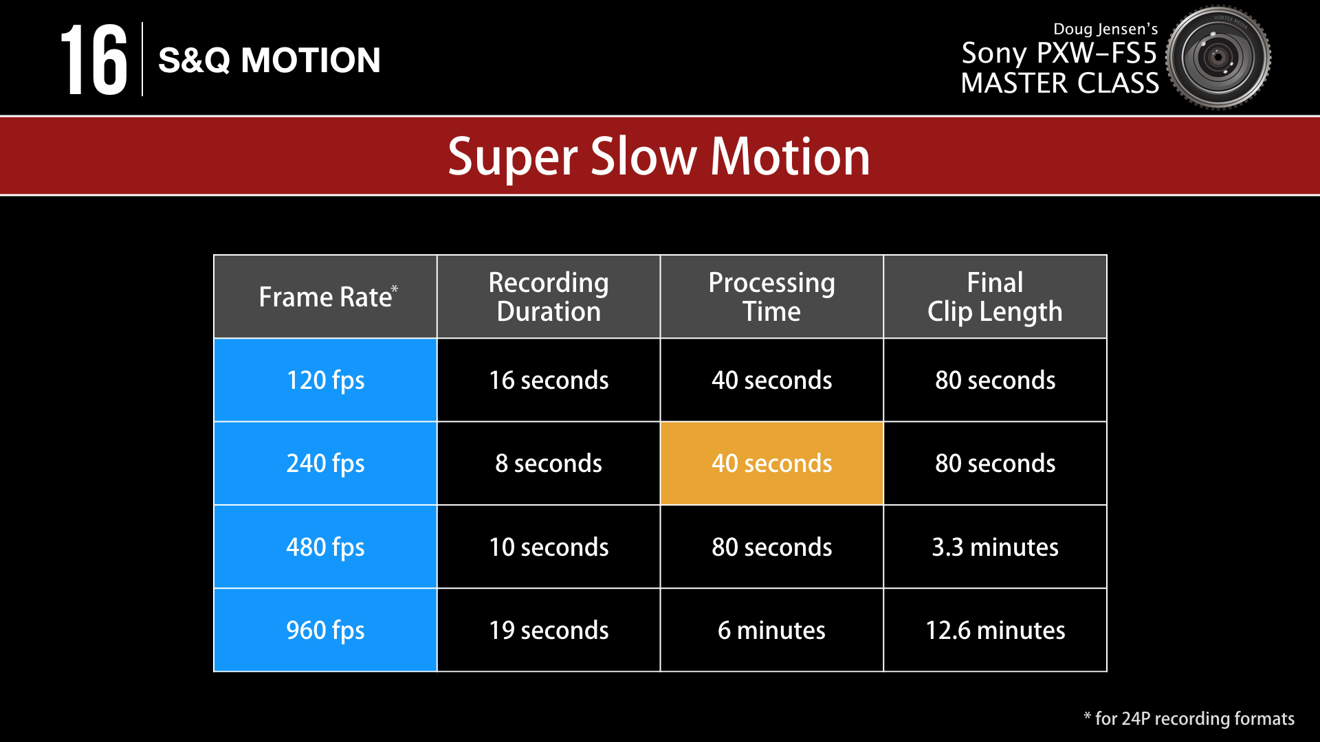

Thx Doug for you video, i just have one more question i hope ))) does the slow motion quality differ between them since the FS5 shoot in burst mode ?

That's a tricky question to answer because the FS7 has overall better picture quality than the FS5 in all shooting modes. Although I've never specifically compared the slow motion head to head, but I would say the quality is similar between the two cameras as long as you don't exceed 240 fps on the FS5. The 480 and 960 speeds on the FS5 are unusable for professional work, and you always have to wait for the slow motion to process before you can shoot the next shot. And of course, only the FS7 allows you to shoot slow motion @ 60 fps in 4K.

As I mentioned I don't care about the 4K and I will be shooting mostly Full HD which means I can't do more than 240fps. But do you know how much time it needs to process the 8sec on 240fps mode ?

Arlen, an agonisingly long time! Can be several minutes depending on 50i or 60i set-up and HFR frame rate choosen.
Look at pages 58-60 in the FS5 handbook. Link posted in post #4 in this thread about HFR on FS5 for more details - quick PDF download:
http://www.dvinfo.net/forum/sony-xdc...ml#post1911335

A graphic from my training video . . .
FS5 or FS7: please advise-fs5-380.jpg
