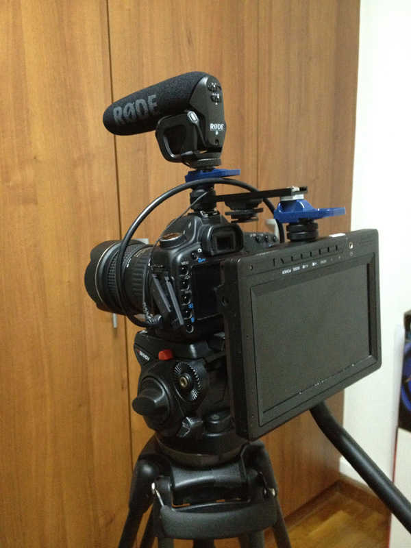

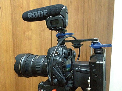

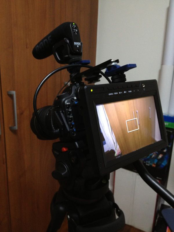

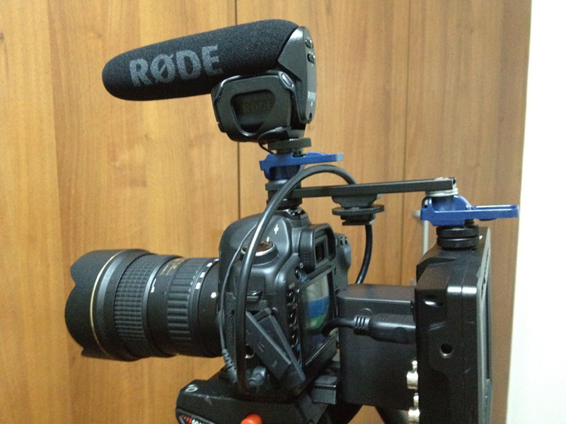

Talked to my local Vitec group contact and he said he still has yet to look into the issue by asking for tripods back. He said he had no demo Vinten Vision Blue tripods or heads to loan out too. Bummer!
I've attached 4 images of a current rig that balances perfectly with my 501HDV at about 2.3 - 2.4kg. The battery of the LCD monitor does not block the sliding plate at all.
It's definitely not a safe rig, especially for the hotshoe. But there's no other way I can get it the way I want it to work for a 501HDV in case I can't upgrade to the Vinten VB or similar in time for my shoot... so maybe an hour of using it like that won't hurt?

I'm not Chris, but I think that I'd first strip down the rig if you want to use it on a VB - it's a 5kg max payload head with limited tilting at max (or getting close to max) counterbalance settings.
