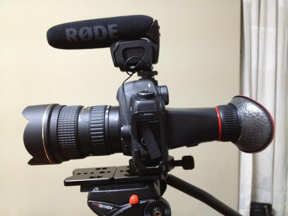

Old February 6th, 2012, 04:00 AM   #45
Join Date: Mar 2010
Location: Singapore
Posts: 102
Re: Upgrading from 501HDV: Vinten VB or Sachtler DSLR/FSB-6?
No worries mate, you aren't obligated to reply fast at all!
I've gotten my dad to try to get a proper cheeseplate done up with 1/4" thread holes so I can mount my quick releases and what naught onto it. Helps increase the weight and raise the CG.
Currently it's pretty balanced on my 501HDV so here's hoping a Vision 3 will work just like that.
Upgrading from 501HDV: Vinten VB or Sachtler DSLR/FSB-6?-fb1.jpg
