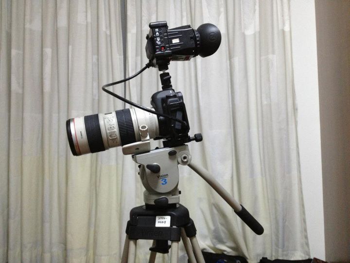

Tried the Sachtler FSB-6 and FSB-8 tripods on 75mm 2-stage sticks. Fiddly. Not stable enough for me i'm afraid! Heads were great, but like expected, I prefer perfect balance.
I went back to Vitec SG today and they loaned me a Vinten Vision 3as with #1 and #2 screws and a grey pozi-loc tripod with (ugh) ground spreader. I'll be using the #2 screw (2kg @ 125mm COG) for the setup I've attached below.
On testing the head in my quiet bedroom, I could definitely hear the bearings, but the jerkiness wasn't there at all, much different than the Vision Blue heads in question. I'll definitely have a good shoot tomorrow!
@ Harm: Seems like you'll be traveling a lot. Perhaps the Sachtler might indeed be a better idea, even though the legs aren't what I want them to be. Like I said, I tried the FSB-6T head today and it was good but.. the aluminum legs don't instill confidence.

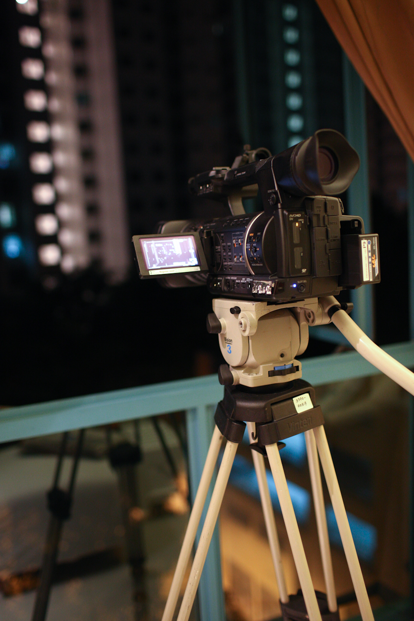

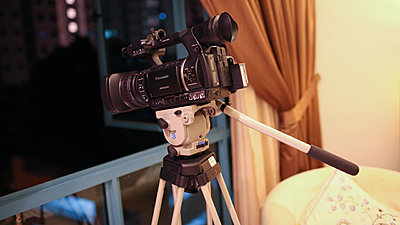

Here's a shot of a Vision 3 holding up the Panasonic AC160 without any attachments. Spring in the head is a silver #2 which should be a 2kg @ 125mm spring. Balances the pana perfectly.
Upgrading from 501HDV: Vinten VB or Sachtler DSLR/FSB-6?-fb-2557.jpg   Upgrading from 501HDV: Vinten VB or Sachtler DSLR/FSB-6?-fb-2560.jpg
