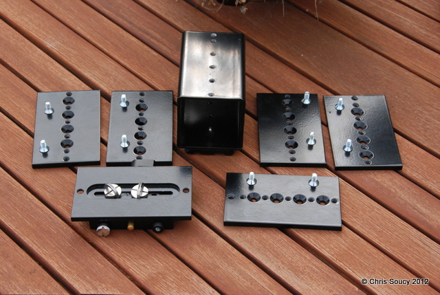

There is another option to the blueBridge, which has some significant extra benefits.
It's the CBTechniques CB100 system that Richard Davidson and I co designed last year, which, strangely enough, the blueBridge was sort of designed to emulate.
The main difference between the two is versatility.
The blueBridge gives you a fixed COG lift of 2" (5.3 cm) and practically no weight increase, it being made of aluminium alloy.
The CB100 was designed to have: 3" wide risers of 1", 2" and 3" high, made of steel, then weight plates of 1/4" thick steel which weigh in at 1 lb (just under 500 grams) each, plus a top plate 3" wide by 5" long of 1/4" steel, slotted to take something like a Manfrotto 577 adapter.
Everything is drilled and tapped to take multiple 1/4" screws, 4 countersunk clearance holes and 6 drilled and tapped for 1/4" X 20 screws.
There are bigger photo's of my full set here: http://www.dvinfo.net/forum/tripod-s...blue5-nab.html
The beauty of the system is that you can configure a COG riser/ weight combo to make pretty well anything CB on pretty well any more powerful CB head, from memory I even got my Canon HV 20 dinky cam to CB on the Vb5 and it weighs in at just under 1 lb!
I've fired a mail to Richard in Texas to see if he's got a system lying around, it was an idea a bit before its time, so we put everything on ice till there was some interest.
Ah, a response already, he's trying to find a full system, he's moved house since last year so things have got a bit disorganized.
If you're interested, I'm sure he'll do you a really good deal.
CS

Hmm I see something that interests me quite a bit in those images. Lemme deviate a bit from all this tripod talk.
http://www.dvinfo.net/forum/attachme...b-dsc_4408.jpg
See that piece connected to the quick release, bottom left? I wonder how much would it cost to just get that piece (perhaps a little thicker?). Reason being that I need a cheeseplate riser solution for my rig to raise the quick release platform just a bit from the actual baseplate for me to access the lever (it's a Kessler Kwik Release). Right now I'm using 2 small cheeseplate squares that give me the height but because of user error in rigging up, won't be 100% straight.
Pics coming soon in another post, but it'd be great if you knew an estimate price!

The plate attached to the QR adapter is called a top plate and is 3" wide X 5" long (75 mm X 125 mm). It must be used attached to one of the weight plates shown in the photo, as the mounting holes in the top plate are further apart at 4 9/16" (115 mm) than the slots in the majority of QR plates it needs to be attached to will allow.
The weight plates however have 4 drilled and tapped 1/4" X 20 holes on 1" (25 mm) centres for mounting to pretty well any QR plate ever made using 2 X 1/4" X 20 screws - 2 because there is no VHS pin involved.
The combined two plates weigh 2.15 pounds (1 kilo) and are 1/2" (12.5mm) thick in total. Add in the COG lift and weight of the adapter itself and you've given that dinky cam a good chance of CB'ing with that too powerful head.
I checked out the Kessler and it looks pretty wide, so the standard plates may just do the job.
Other sizes are possible, though one offs are always expensive.
You give me the details I'll see what Richard can do, though he's probably reading this as I type.
CS
