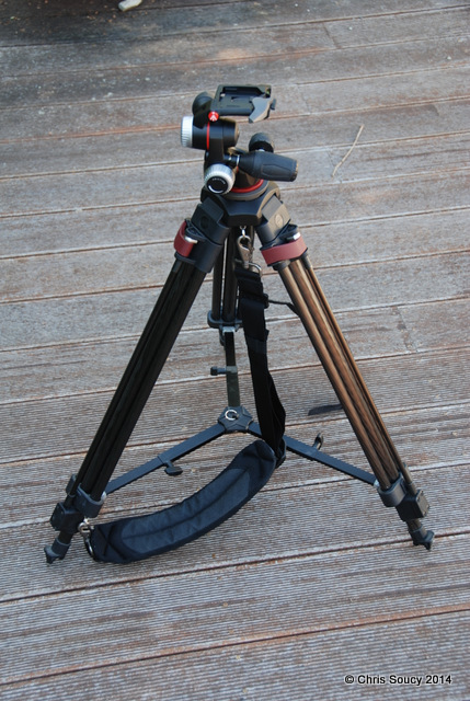

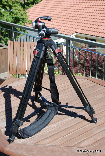

The 100mm Solo's certainly are versatile, no doubt about it, BUT......... those three concentric twist locks per leg would drive me nuts in pretty short order. That's a mind numbing 18 twists from collapsed to collapsed!
I'm currently re- tasking a set of Sachtler 75 CF Speedlocks ( Speed Lock 75 CF - Sachtler) from very average video platform to bees knees lightweight super quick stills rig - one (1) latch per leg! Yay.
Not everything in the garden is rosy, the non detachable spreader sucks, but as it's main purpose is landscape and not macro bug hunting, I can live with it.
Mated with a Manfrotto 520Ball (520BALL 75Mm Bowl With Knob 520BALL - Others | Manfrotto) and a MXPRO 3 way head (X-PRO 3-Way Head With Retractable Levers & Friction Controls MHXPRO-3W - 3 Way Adjustable Heads | Manfrotto) it works very well indeed.
With that in mind, have you given any thought to something like the Sachtler 100mm Speed Lock CF's (Speed Lock CF - Sachtler) or, hernia notwithstanding, the gut busting Speed Lock CF HD's (Speed Lock CF HD - Sachtler)
For those "bite the dust" low shots maybe a high hat with the Sachtler SpeedLevel clamp, it appears to be shorter than the standard one (I'd link it but it won't let me).
Just some food for thought.
