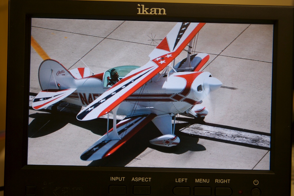

Here is a pic I snapped of one of the IKAN V8000HD's that we got in stock today.
Great picture, extremely lightweight and affordable at $799. The competing Marshall 7" monitor we also use is big bucks when you take into account battery power for shooting on the go. The IKAN uses Sony batteries. The Marshall can use two Sony batteries with an add on $299! http://lcdracks.com/accessor/V-DV-PWR1.htm
The IKAN accessory kit adds a charger and battery for $99. http://www.dvcreators.net/ikan-8inch-lcd/

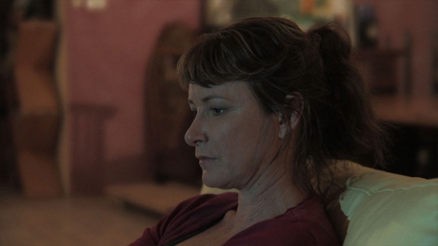

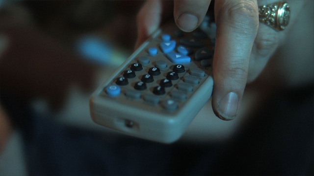

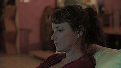

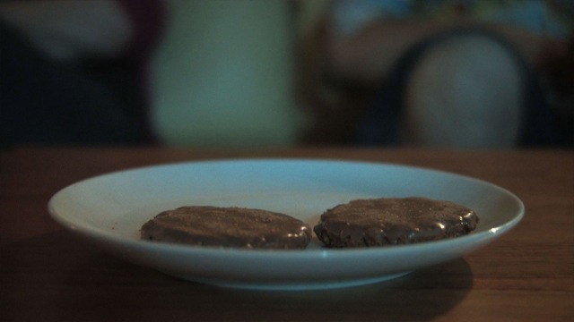

We used a Macbook with FCP for critical focus - it was a pain due to the delay (we thought the camera had some sort of delayed autofocus on) but it did the job once we got used to it.
before you spend any money on any monitor I'd test it thoroughly - it's so easy to end up with soft focus when you think it's spot on
