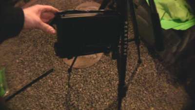

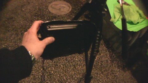

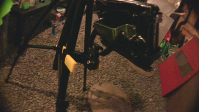

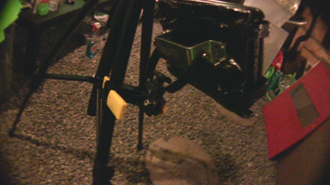

DIY DVD Player Mount for Tripod/'Steadicam'
I made this mount for the Sony 820 out of a some sheet aluminum, copper plumbers tape, and a worklight that came w/ a clamp-mount. I took the worklight off the clamp, bolted the aluminum to the frame I built out of the plumbers tape, then pieced it all together w/ a big bracket.
I love it because I can take the dvd player in & out whenever I want to, and I don't have to deal w/ velcro, which I really don't trust in the long run & don't want to deal w/ if I ever want to just watch a dvd.
The bendable plumbers tape on the left side allows me access to wires and switches when I need them, and keeps the player secure when I don't.
The whole thing is wrapped in duct tape a couple times, to protect innocent bystanders from any crazy injury. This, plus the bracket size and metal plate, adds extra weight that I would think about getting rid of. I can't convince myself that the metal plate isn't needed for security, as I don't trust a frame built on the tape alone. The same goes for the bracket size/width, as I want the strength, but I know there are thinner/lighter options out there.
