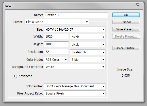

The next hurdle is authoring. I want to create my menus in Photoshop, import to DVD Architect, and use buttons with no text over my menu selections. I'm having a hard time figuring out what size to make the Photoshop file and where the "safe zones" might be. Any suggestions?

I'm still working in Photoshop CS3 but CS5 should be the same. Open Photoshop got to
File->New->
Under Preset select Film & Video, choose Size to be HDTV 1080p/29.97
The image will be 1920x1080 at 72 pixels/inch. The attached picture is the screen showing the settings.
The canvas will show 10% safe areas.
-Garrett

Re: Amateur Recital Video Editing
Should I still be using the 1920x1080 setting even if my project is at 720x480 in DVD Architect?
