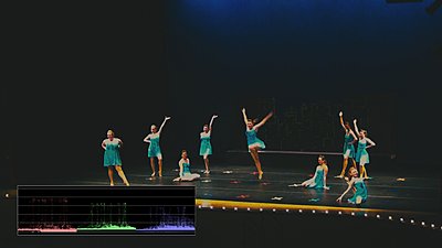

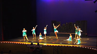

Interesting, had a play with the original clip for about the last half hr.
I agree, its not that bad, but, I can see why you may want it to be a bit better.
The bottom line is (as always) you cant unburn a chicken.
The details in the highlighted areas are gone, and you cant get them back,
but,
if you wanted to retrieve as much as you can, here's one way-
If you have Cineform render to that first,
If not, open your scopes to RGB parade, View-Video scopes.
Apply a colour corrector, what you are aiming to do is bring any clipped highlights down,
Lift your Gamma, Lift your contrast, drop your Saturation, Drop your gain.
watch your scopes, aim to get a very soft image in the middle of the spectrum.
Render it out to something lossless when you think its as good as its going to get.
Bring it back in, add some sharpen, add some colour, add some contrast.
You will end up with something different than what you had, whether its better or not is subjective.
If you were going to apply a film look or some diffusion, this process is worthwhile as you will stop anymore clipping than whats already happened.
But really..... its not that bad.

forgot the pics
Amateur Recital Video Editing-orig.jpg   Amateur Recital Video Editing-graded.jpg

Thanks guys for the input! Maybe I am being a little picky here, but I'm not sure what to expect as this was my first time ever doing something like this. I agree that on my PC monitor, the picture is not that bad. However, when I watch it on my plasma TV, it looks a lot worse to me. Maybe it's my TV settings as Dave has mentioned in the other thread. Also, the final video will be delivered in DVD format, so I'm not sure how different the picture may look once I get the final output to that level. I guess I should try a sample to see.
The footage from this CX160 is only going to be used to cover up my mistakes that I made with the XR500 which was my main cam. The CX160 was fixed at the angle in the clips for the entire 5 hour show. The CX160 doesn't have the AE shift that Ron mentions, it only has a slider bar on the view screen to manually adjust the exposure. If I would have been manning this cam, I would have noticed right away that the exposure was too high and lowered it as needed (like I did when checking the cam after 2 hours). With the XR500, I did have the AE shift set to -4 and I got a great picture from that cam. However, with me being new to this world of videography, I made a lot of mistakes with XR500 that I would like to fix by cutting to the CX160.
I've already tried playing around with some FX in Vegas - level controls, brightness and contrast, etc. I couldn't come up with anything better than the original myself. Thanks to Gerald for making some adjustments on my clip and posting some samples. I like what you've done, but I think overall the entire scene got too dark and would be too much of a contrast when cutting from the XR500 to this.
I think I will just live with the picture the way it is and just make as little cuts as necessary to this cam.

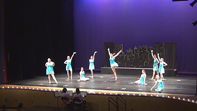

Yes, it does get dark,
If you move to After Effects (if you had access to it)
you can do this in about 90 sec with a Luma matte and then correct that without darkening your whole scene.
