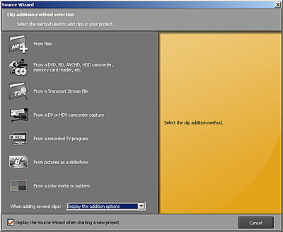

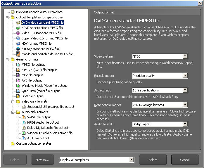

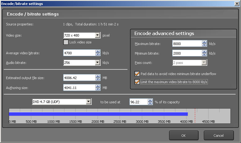

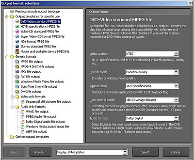

TMPGenc is straight forward not sure what you are doing. Start new project>Source> Input file>Format> select DVD standardMPEG file preset( select NTSC, prioritize: quality, Aspect ratio: 16x9,rate control VBR, audio: Dolby Digital)> Select> adjust ", set bit rate,( you will see how the bit rate effects the disc fill on the bottom scale)( VBR is 2 pass and the time you stated is about correct for 2 hour file I normally set the 8000kb/s limit too, I normally press the arrows on the average bit rate box until the disc is at about 4G fill on the scale )>Press OK . On this page I set DC precision to 10bit and motion search to highest. Select ES seperate video and audio> encode.Select where the file is to go.> Start.
TMPGenc will set field order correctly for NTSC so do not touch. I normally choose separate video and audio files as most authoring programs prefer this form. 2 Hour program should have an average bit rate around 4000.
These instruction are for TMPGenc 4Xpress but they are much the same for T5 other than the motion search is now under the advanced settings or can be set as computer performance "slow".

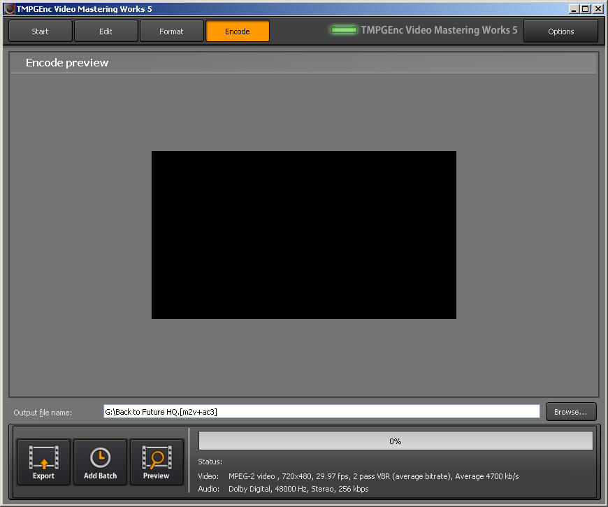

When you open the file in TMPGenc does it recognize it correctly? If you press Cut-edit can you scroll through the video? If you can do this then TMPGenc is recognizing the file and will be able to decode it. YOu will not see anything in the preview window when it is encoding unless you have specified ShFT+Ctrl+P when you are on the final window and start encoding. Its the button on the right.

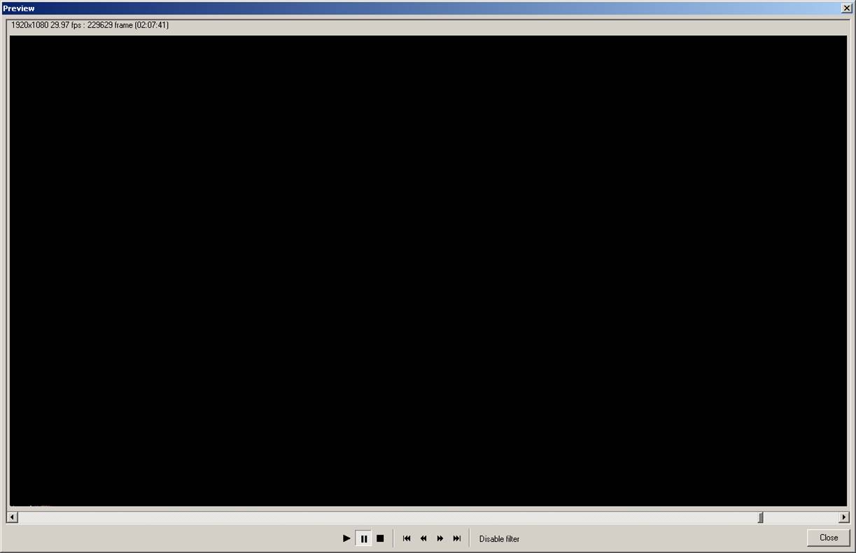

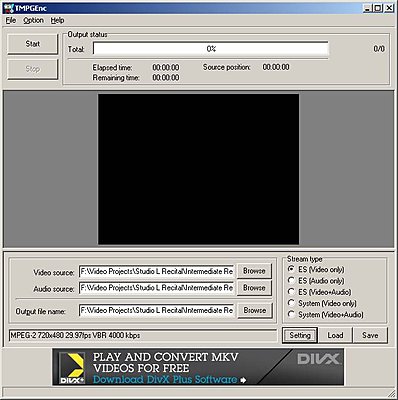

Re: Amateur Recital Video Editing

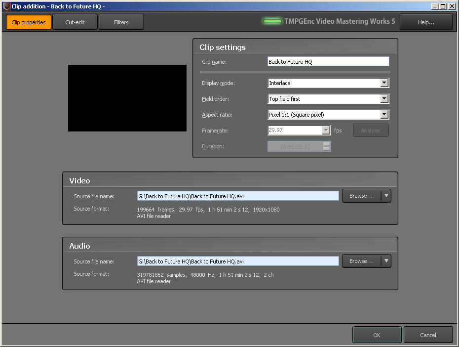

TMPGenc allows me to to load my file as the video source just fine (no errors) but when I choose preview it shows just a black screen with no video. It shows the correct number of frames, length, etc, but just a black screen. Screen shots are attached. I'm stumped. I was really hoping to use TMPGenc for encoding before authoring the DVDs. For some reason TMPGenc is seeing the Cineform files properly. I can load other AVI files into TMPGenc with no problem and be able to preview them, but not these Cineform files.

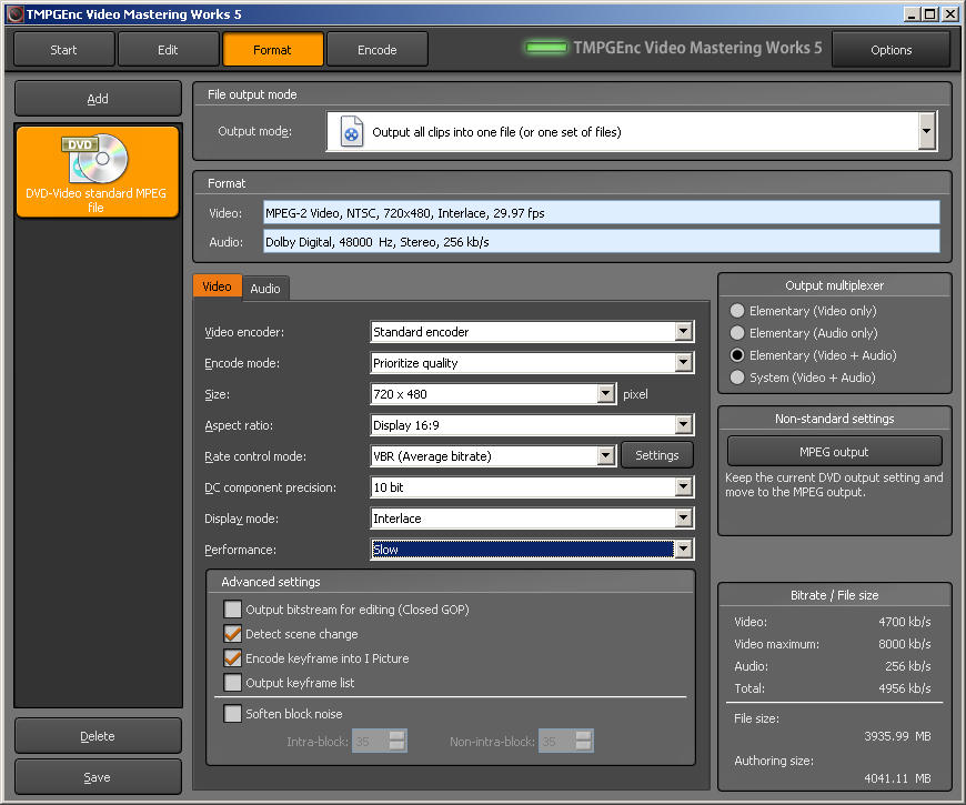

On your TMPGenc T5 preferences , click on AVI and it will list all the codecs. Is Cineform there? My T5 shows Cineform HD Codec v 5.1.4 ( CFHD) . Do you see the video in the Cut-Edit window?
Ron Evans
Old June 18th, 2011, 01:16 PM   #66
Join Date: Mar 2003
Posts: 4,222

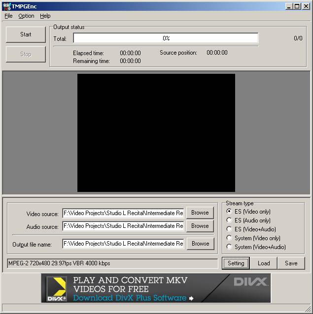

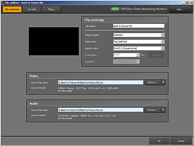

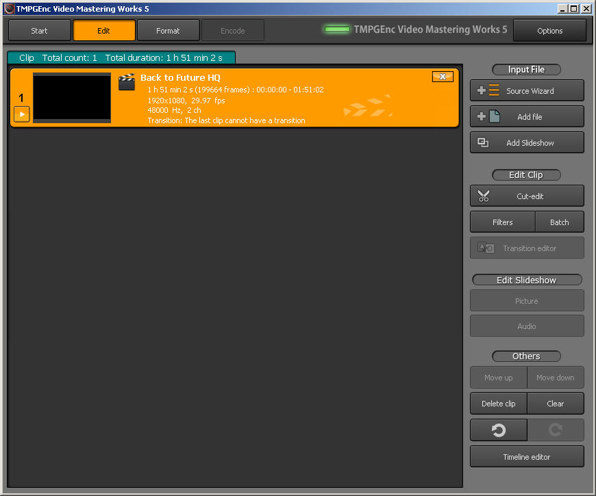

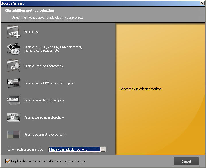

I have attached the full sequence in T5. Hope this isn't too big.
Ron
Amateur Recital Video Editing-files.jpg   Amateur Recital Video Editing-file-accepted.jpg
Amateur Recital Video Editing-input-file-accepted.jpg   Amateur Recital Video Editing-dvd-format.jpg
Amateur Recital Video Editing-encode-bit-rate.jpg   Amateur Recital Video Editing-summary.jpg

I downloaded a different version that what you are using. I have the following...
I will see if I can download a trial version of the Authoring Works and see if that works for me.

Try Masterworks 5 which is what I took the pictures from . It is very similar to version 4. Authorworks is the complete authoring program.

Masterworks 5 worked GREAT! Thanks Ron for the help.
