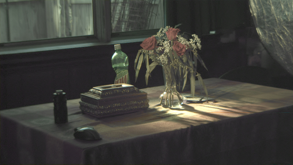

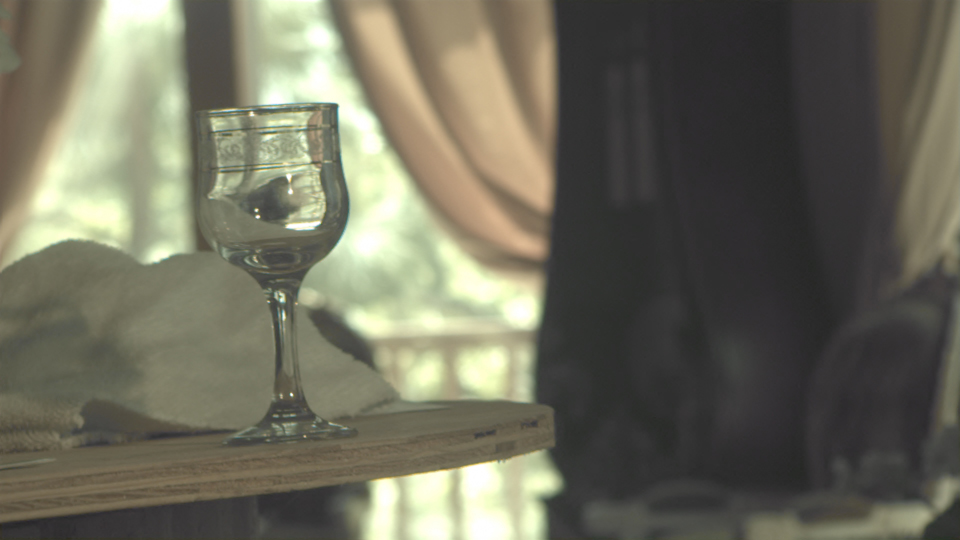

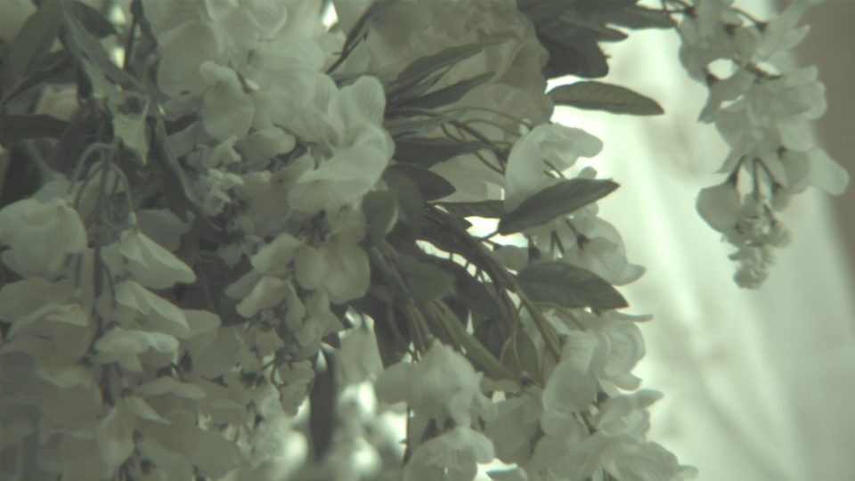

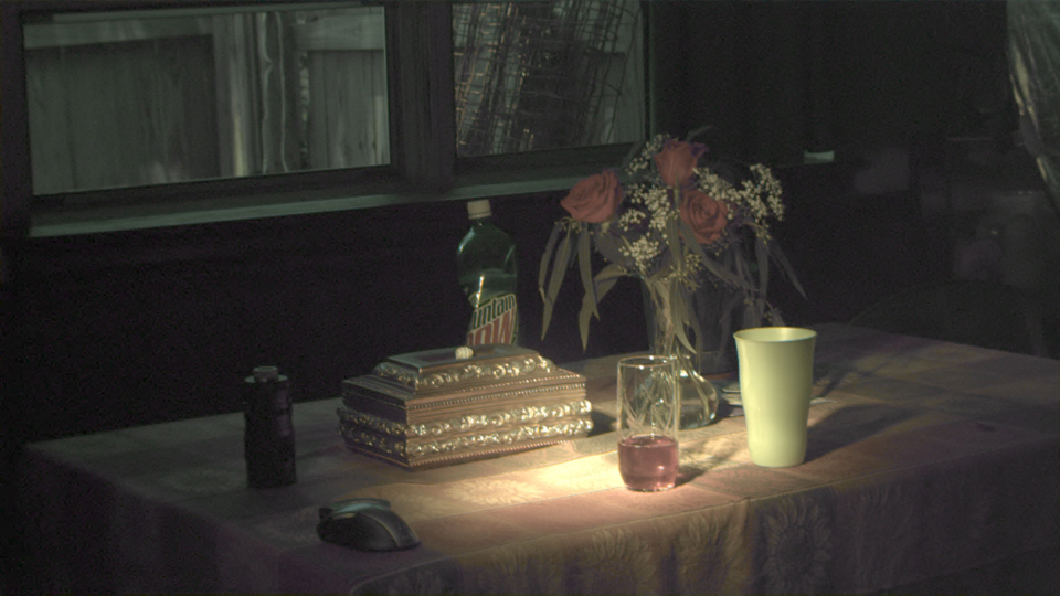

Hello Daniel,

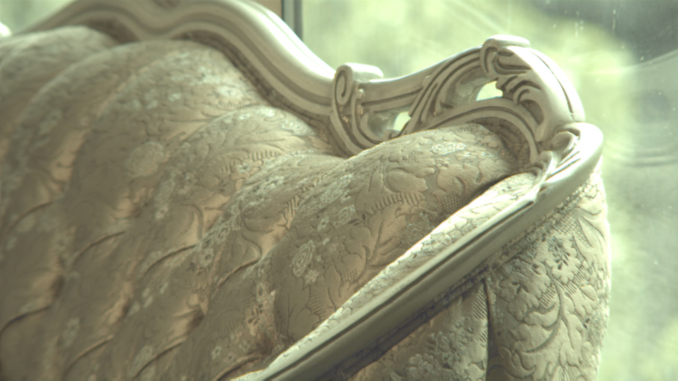

This may be a little too late, but I think the reason your Cineform RAW AVIs look different from SI-2K's ones is because SI applies a 12-bit linear to 10-bit log transfer before the encoding while yours are untouched. SI does it to preserve the most of the 12-bit linear data into 10-bit, and though the image may look right, it isn't. Not mathematically anyway. It just so happens that the linear2log curve is very similar to a gamma curve.
A true linear (gamma=1.0) image will look very dark on a standard gamma 2.2 display. Though it may appear featureless at the dark area, the detail is still there. All you have to do is apply a 2.2 gamma correction in post to get a normal view. Make sure you use 16-bit/channel project setting if you are using AE, for if you clip it to 8-bit/channel you may get color banding.
Here are some test images of your clips. No CC was applied other than the 2.2 gamma correction.
Sumix 2/3" 1920x1080 CMOS-1.jpg   Sumix 2/3" 1920x1080 CMOS-3.jpg
Sumix 2/3" 1920x1080 CMOS-5.jpg   Sumix 2/3" 1920x1080 CMOS-6.jpg
Sumix 2/3" 1920x1080 CMOS-smx12a2c.jpg   Sumix 2/3" 1920x1080 CMOS-underexposed.jpg

Eric,
Yeah you are correct it is the gamma. There is a Gamma Correction option in the new software which appears to have the same result. The last few images I posted is with the option enabled.
Sumix is currently working on a software update with more features and better designed for our application.
Daniel Lipats is offline   Reply With Quote
