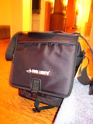

I received the LED 600 lights air freight from Richard in China last week. Both lights came packaged nicely. The nylon bags that the lights come in are very nice, black ballistic nylon with a white Coolights logo silk screened onto the front with an adjustment strap. The bag also features plenty of room to house the power supply for the lights.
http://www.dvinfo.net/conf/attachmen...1&d=1232432579

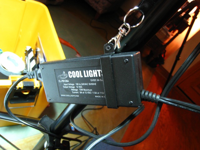

A very nice lanyard with a aluminum caribiner clip is attached to the lights so that the power supply can be hung from your light stand. This adds the benefit of better air circulation around the power supply. As we all know, less heat equals longer life in electronics. Since I am in the U.S., the power supply came equipped with a detachable 12' standard grounded threee prong OSHA cord. The cord is heavy duty and not cheaply made. Not sure what the AC cord supplied for 240 V countries will be like. The power supply itself is variable voltage so it will be the same for all LED 600s the world over. The power supply terminates in a four pin DC XLR cable.
http://www.dvinfo.net/conf/attachmen...8&d=1232432576

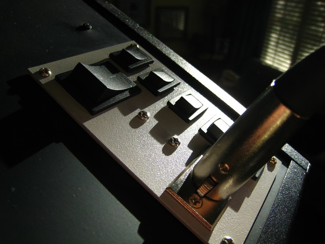

The rear of the light panel contains a larger master power switch flanked with five bank power switches. This allows you to vary the output of the instrument without dimming. Dimming in LED fixtures does cause a shift in color temperature in the output, although this varies from instrument to instrument. The light also features a nice rotary dimmer underneath the fixture near the light stand adapter. I like that the dimmer knob is fairly long, it makes it easier to find in the dark or when you are not looking underneath the instrument for it to adjust it. The dimming effect is nice and linear, no major jumps in the dimming percentage. I do not own a color meter so I was not able to measure the color temperature shift as the instrument was dimmed, but I assume that there is some shift.
http://www.dvinfo.net/conf/attachmen...1&d=1232432646

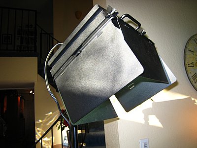

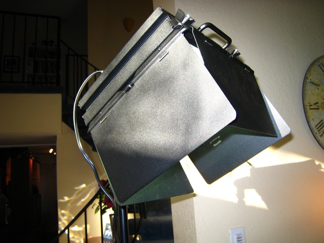

The light will fit into the main compartment of the bag with the included barn doors in place. The barndoors are very nicely done and extend to about 8" on all sides. Since the instrument is square, it seems as if all four barndoors are the same length. This makes folding the doors up easy and quick since you don't have to search for which set of doors are the horizontal and which are the vertical as you would on most lights. Richard has discussed the possibility that he may supply various accessories for these lights in the future that could include color correction panels, diffusion panels and possibly a speed ring for softboxes. The channels that hold the barndoors and would be used to hold these opther accessories are very heavy duty and could easily hold additional weight and width besides the barndoors. The clips that hold the barndoors to the light are spring loaded and heavy duty, much as you would get on an Arri or other professional instrument.

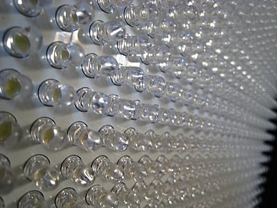

The front of the instrument features six hundred 5mm LED lights, arranged in a square. The LEDs are bare, there is no safety glass or protective panel in front of them, although with the barndoors folded over the light, the LEDs are protected during transport.

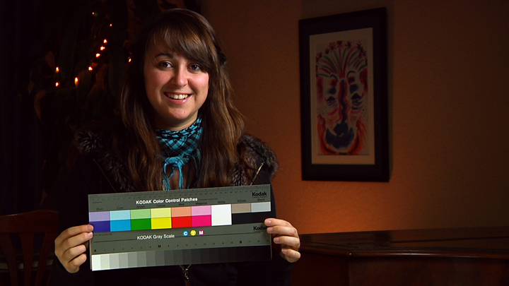

Color Cast
As expected, the LED600 panels do exhibit a small green spike in the color output. Evidentally this is endemic to 5mm LEDs and I can tell you from experience that the LED500 Prompter People panels also exhibit the same green spike.

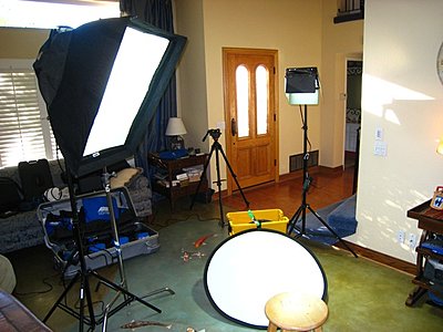

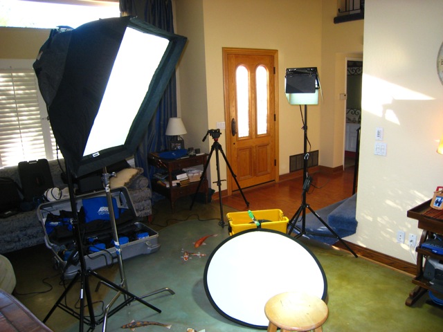

The stills below were taken with the setup shown below with the spot panel punched through the small Chimera as a key source and the flood panel bounced off of a 42" white flexfill. LED lights have a harder light quality than fluorescents so I would typically not use them without diffusion or bounce. I was concerned that the LED 600s might not have enough output to use as a bounced instrument or for use through a softbox but they surprised me. They worked quite well, both through the Chimera and bounced off of a Flexfill. The samples below are lit only by the two LED Panels, the only ambient light in the room was an incandescent practical shining on the wall (the orange looking wash on the picture) and some twinkle lights on the potted plant. Both practical sources were located about 18' behind the subject so they did not affect the color cast on the subject at all. There was no hairlight or rim light used to separate the subject from the dark BG.
(this still was shot during the day but the test shots below were shot with the same setup at night
The first image was shot at 5600k wb preset on the camera.
The second image shows the same image after color correction in FCP's three way color corrector using the grayscale chart the subject is holding.
I am going to shoot some images using manual WB, which I suspect will work almost as well as FCP's three way color corrector. You can see that under the 5600k preset on the camera, the lights do have a definite green spike although it was quite easy to correct with the color corrector in FCP. Another alternative would be to mount some -1/8 green gel in front of the lights while shooting. There are three easy and effective solutions to mitigating the slight green spike in the LED600s.

Dan,
I've received my Coollights now too, they are pretty impressive. I took the battery plate option though. One quick question, what softbox are you using on the one in your picture? and how did you attach it?

Hi Dan:
That is a small Chimera Quartz bank (24" x 36"). It is actually not attached to the LED 600, it is being held in front of it on a separate C-stand. I have been speaking with Richard how users will want an integrated or add-on speed ring for softboxes for these lights so hopefully one will be forthcoming. In the meantime, I may create one for myself.
I already looked through the existing 250 models of Chimera speed rings on the market and none look as though they will fit the 9.75" wide channel on the LED 600 so at this point, I may have to fabricate my own or go to a metal shop and have it done. I am sure that Richard can have them made much more efficiently in China though. Really all that needs to be done is to take the barndoor frame, remove the door panels and weld on four socket receivers for the Chimera rods. Piece of cake.
