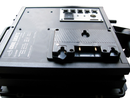

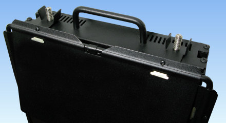

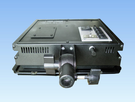

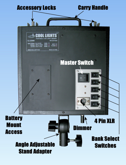

Old December 28th, 2008, 10:20 AM   #126
Location: Shenzhen, China
Posts: 781
Pictures!
Finally have some LED 600 panels rolling off the assembly line. Here are the promised pictures I took today of one of the units including of the back with some descriptions. I'll try to include one tomorrow with a battery plate attached. To attach a battery plate (V or AB) to the back of the unit, simply remove the 4 screws and take off the door on the left, pull out the molex battery plate connector (keyed so there can be no mistakes), attach to the battery plate, screw the battery plate down and you're ready to go.
The picture on the right shows the bottom of the unit with dimmer and stand adapter.
The picture on the bottom shows the top of the fixture with the carry handle and the spring loaded accessory locks which hold the removable barndoors in place.

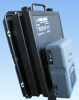

Old December 28th, 2008, 08:24 PM   #133
Posts: 781

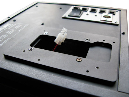

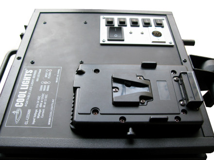

On the subject of battery plates. I just took some pictures showing the battery plates and how they attach. Pretty standard stuff although I certainly haven't taken a survey of all the different options out there and how they all work. Ours have a bottom plate which attaches to whatever and then a top plate with the battery adapter on it that attaches to that. First pictures shows the V Mount bottom plate just attached to the back of the unit. You can see the molex keyed connector sticking out ready to attach to the battery plate. Next picture shows the V Mount attached to the bottom plate. 3rd pictures shows an AB Mount plate attached instead of V Mount. 4th pictures shows an AB Battery on the fixture with the AB Mount.
http://www.coollights.biz
Richard Andrewski is offline   Reply With Quote

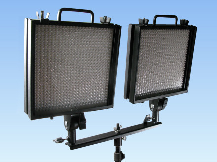

Old January 10th, 2009, 10:38 PM   #134
Posts: 781
The Blinder! Or, a quick way to get 1200 LEDs (or more) on one stand.
The CL-LEDHBAR allows placing two fixtures on one baby light stand and includes two baby male 5/8" studs on a powder coated, lightweight steel bar and one baby 5/8" female / junior male adapter at the bottom.
The CL-LEDVBAR allows stacking the CL-LEDHBARs vertically for 4, 6, etc. panels on one light stand. Availability at same time the panels hit stock.
