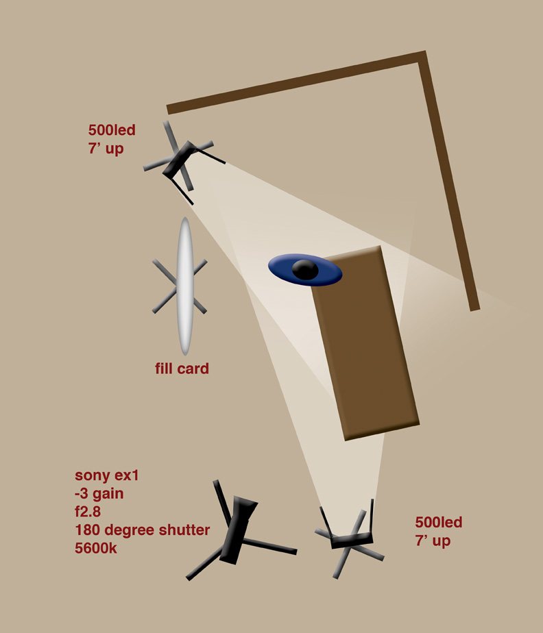

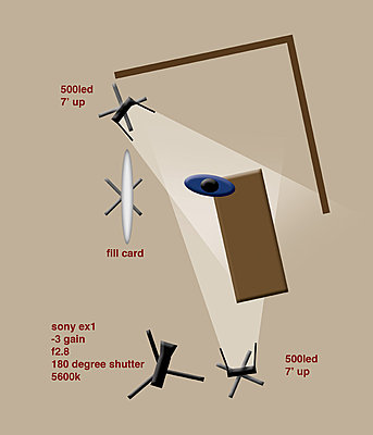

sure... here's what I recall.....
but... I'm not showing the teleprompter on the camera here.... don't know/think it's cutting the exposure down much through the beam splitter.

Christopher, thanks for the schematics.
I had a feeling you did away with only one key light :)
Since your hair light was to the side, it did provide a nice kick on the side of the presenter's face, though.

Hey Christopher, nice footage & thanks for sharing!
Just wanted to share my opinion on the lighting and talent position, please accept it as constructive.
I would have enjoyed more key on the subject as there was not much of a ratio between subject and background. The hotter kicker was drawing my attention.
Also, I would have enjoyed the talent to be angled a little more to the key rather than the camera. He was kind of square shouldered.
Also, a tighter shot would give the appearance of a more personal connection, maybe a creep in as the speech unfurls.
Best of luck!

well, I would not call him talent as he is the president of a 17 campus college system.
I like the way he is lit.... gives shape.... I think I know what I'm doing.
I only had a few minutes of his time and he nailed his "speech" from the teleprompter in one take. He is over to the left for several reasons.... 1. because I'm a believer in 2/3rds rule when composing... and 2. because there will be "copy" placed to the right of him referring to topics he is discussing. ( this is a rough draft.... no layers yet ) and 3. he's no supermodel and I'm not about to use a cybil shepard filter on him.
As this video will be a "web view" I can always creep in on him in post... but I'm not going to.

LOL, Christopher - not with interior design, but...
1. Have you thought of doing all your set interviews as green screen instead.
Then you'd only care about lighting the talent, and you could insert any background design you wanted, in post.
I've done green screen extensively in my studio, but never on location - mainly because it's very hard to light the green screen right, especially on location.
But - I hear stories (including from Philip Bloom) that Reflecmedia kits eliminate such hassle.
So then you could do Reflecmedia for background (no lighting at all, and complete freedom of what it will look like in post), and say your two LED lights for talent only.
2. Why LED and not Fluo lights? I bought 2 Fluo lights in almost exactly the same fixtures like you have, one light is 4x 55W Osrams, another 6x 55W. 5500K. Looks great in limited tests, did not try on anything real yet. Seems like Fluorescents have better diffusion and cost so much less than LED lights...

Christopher,
Sorry I put you on the defensive.
I look at this website as a place of learning and open exchange.
There are so many ways to light a scene, just thought I would tell you what went through my mind as I watched the clip.
BTW, by mentioning angled talent I was referring to the angle of the shoulders with regards to the camera rather than shot composition.

normally I do prefer the 4 and 6 bank flos... but they were set up in another room for the other shot..... also, I thankful for their ( 500led ) light weight and can carry 2 on stands at a time.
like I said.... I only had a few minutes of his time and needed to get set up fast.
I've done a few green screen shoots with great success.... but sometimes it's just not an option. and.... I try not to freak out a subject like this one by making it a big production. Having a 24" 1080p monitor near the camera showing how it all looks really helped him get in the mode for it.... a literal view.
Like I said earlier in the thread.... the LEDs are fantastic for quick setup and durability.... I can rely on them to work. they do not compete with the output and quality of light that the 2, 4, and 6 bank flo lights do.

That's cool... I realize your just trying to help. I'm sure If I had more time on this shoot I would have styled it a little better. But I think a better tone to this forum would be to answer when asked... unsolicited opinions are rarely appreciated in any environment. This thread is about LED lights and I was adding to their merits and disadvantages via example.
They availability of low cost flo, led & hmi lights have made it much easier to achieve stylized images in both video and still photography.... I have started using continuous daylight fixtures in my commercial still photography more then ever.... not having to wait for my strobes to recycle.... really seeing what you get rather then having to look at a monitor for a preview is really nice.... the downside is that I tend to shoot a lot more frames.... a typical still shoot for a single layout can yield a 20GB folder of raw 16bit images with my canon 1ds3 or phaseone back. It's kind of interesting that when I opened my studio in 1989, I shot mostly 4X5 and 8X10 and used tungsten lights to shoot most things... Getting back to continuous lights feels more like home. If I had not entered into shooting HD video a few years ago ( client wanted footage of product spinning for tradeshow 50" screen ) I don't think I would have discovered that these LED's or Richards 150 hmi lights existed. Richard... you have a whole other audience to sell your lights to.... us still photogs!
Like I said earlier.... I do have a wish list of lights that do not exist.... large ( 18" X 24" ) LED daylight panels.... very thin, very light, 12v xlr, 4 times brighter than a 500led ( 2000 leds? ) just a simple fixture with black barn doors and bank switchable ( or dim'able if it keeps it's color ) .... I'd pay $1500 each for em and sell all my flo lights. I'd compliment them with 150 to 575 hmi fresnels.
