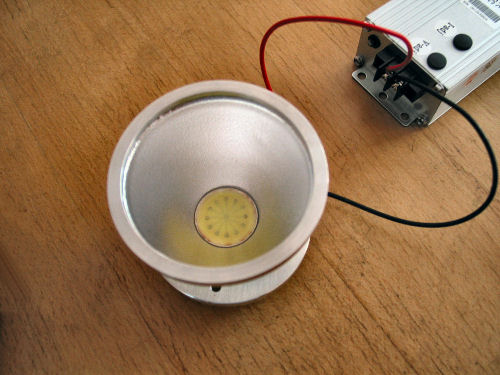

In the summer of 2007 I had great hopes of making a fresnel with a 60w LED from Taiwan but there were a number of issues that kept it from happening. #1 issue -- the cost was too high. By the time we got through this thing would have been close to a $1000 selling price and we just don't see the value there. A $1000 fresnel that puts out about the equivalent of a 300w tungsten. Also, the surface area emanating light was not a true point source and it didn't work correctly with the reflector that came with it. Color temperature was in the 4000K range and CRI was terrible. On top of all that, the heat sink had to be super big to keep the LED healthy so I gave up on that.
Next, we found that Luxim Lifi unit which has some promise, but its current form isn't suitable for stage / studio lighting IMHO. It comes in a fairly large package with heat sink and fan built in. The package alone keeps it from being in a fresnel type fixture. The fan was also a deal breaker.
So, for now, metal halide continues to be the king of energy efficient point light sources for fresnels and pars. Any LED or similar type advance needs to not have such high heat output requiring a huge heat sink or fan and we also need to be able to focus it into a beam as necessary whereas the high wattage LEDs come in a wide beam pattern of 90 degrees or above in most cases today and that won't work for a fresnel.
