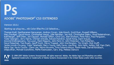

I have CS3 Production Premium. It has worked just fine since I purchased it in 2008 on my AMD Athalon X2 dual core pc running Windows XP pro. I recently upgraded to Windows 7 Pro - 64 bit. By upgrade, I should say I did a clean "new" install on a new C; drive. My CS3 and all video editing software is on G: drive. I reinstalled CS3 from the original discs. All seemed to go okay, but in the All Programs list under "Adobe Creative Suite 3 Production Premium" there is no listings for Premiere, After Effects, Encore, or Photshop. I have Adobe Device Central, Extended Scripting, Flash, Illustrator, Soundbooth, etc., but not the main ones that I use. I tired the Adobe site, but couldn't find any helpful info there (its all pumped up on CS5). Anybody else having this problem, or found a solution? I'd sure appreciate hearing from you. Thanks - PK

Thanks Harry and Ervin. I tried uninstalling the entire CS3 suite and reinstalling. Premier seemed to work, but Photoshop seems to hang up indefinitely while loading. See attached image. I don't know if just reinstalling photoshop again will work or not. I'll give that a try tomorrow night. It seems to hang at the "Starting-up Plug-ins...nik color effex Pro 2.0 Selective...."
Is it just that plug in? Is there away to disable it during start up?
Thanks again guys for your help - PK
