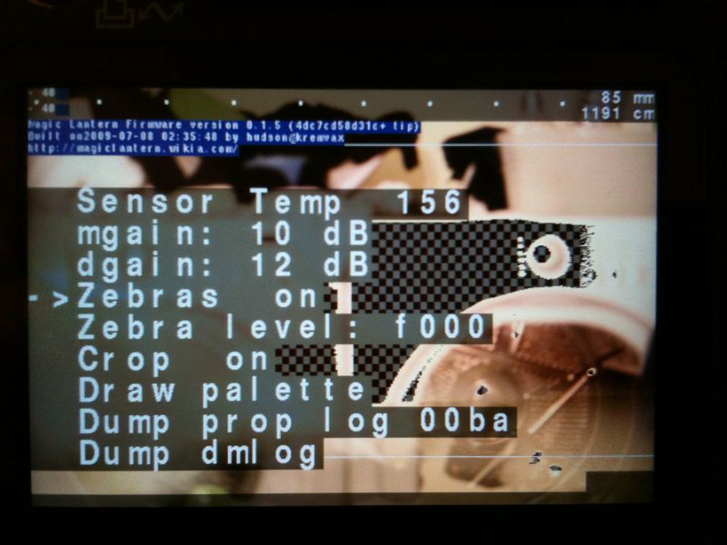

Magic Lantern 0.1.5 release
Release 0.1.5 of Magic Lantern is available from the wiki: Magic Lantern firmware download and Frequently asked questions.
New features:
* Config file (magiclantern.cfg) support
* Lens zoom and focus distance readouts
* Only re-writes the AK4646 registers when necessary to eliminate the 1 Hz clicks
* Power save disabling
* Preliminary HDMI support (overlays are not all in the right places)
* Auto-liveview can be disabled to support problematic cards
* Larger menu font
* Preliminary Sobel edge detection for "video peaking"
Last edited by Tramm Hudson; July 8th, 2009 at 10:02 AM. Reason: Added link to FAQ

I forgot to mention two new features:
# CMOS temperature readout (maybe; not certain of units)
# Semi-Transparent zebra stripes
Tramm Hudson is offline   Reply With Quote
