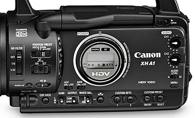

Old July 26th, 2006, 06:57 AM   #30
Join Date: Oct 2003
Location: DFW area, TX
Posts: 6,117
Images: 1
A couple goodies for you to look at while we await more info..
-gb-
