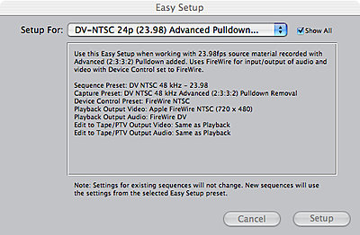

The capture issues may be related to using a deck other than the XL2. I had that issue before. I would suggest that Allen try capturing the footage with the XL2.
As for FCP settings, if you have the current release 5.1.1 there is an easy setup for getting 24p advanced. See the image below.
-gb-
